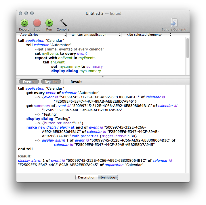

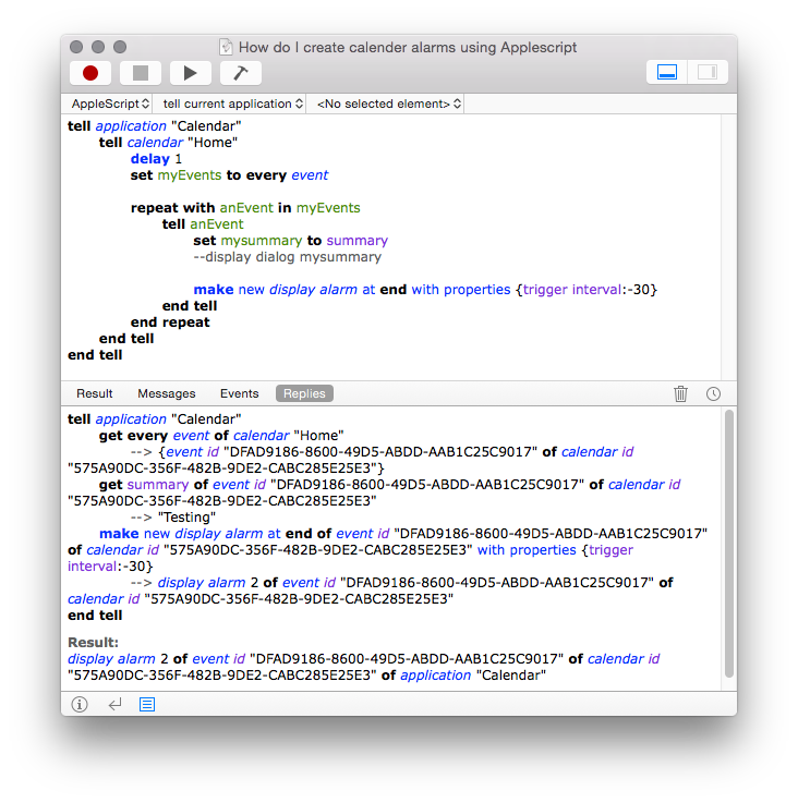

Please post the output of Events and Replies when you run the script.
Note : Screenshots of a quick test on Mavericks and Yosemite.
