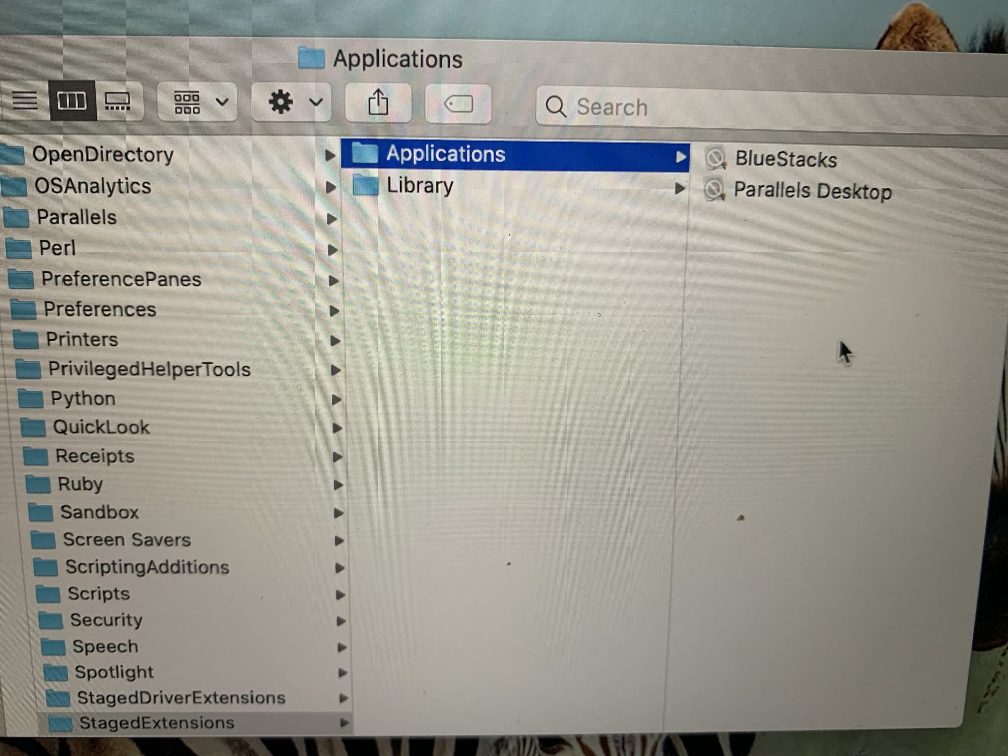

destroyedreason
macrumors newbie
I uninstalled BlueStacks and all of the corresponding files but don’t know how to remove this from the library. I posted a screenshot. Hopefully someone out there knows how I can remove the file. You will notice there is a white circle with a line through it.
I even tried reinstalling BlueStacks then uninstalling it again to try to get rid of the residual file.

Since I assume just regularly moving it to trash didn’t work, open Terminal, write
sudo rm
and drag in the file - if it’s a directory package you will need the -r flag. Then hit enter and write your password, and hit enter again; it’s gone.

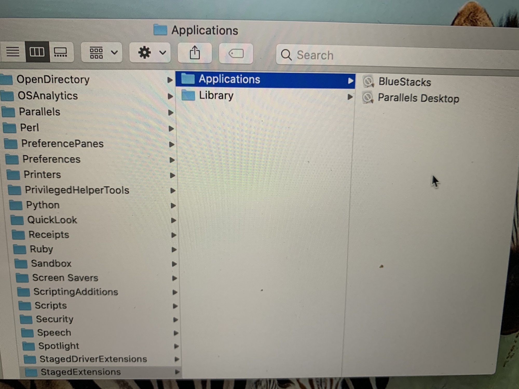

And hey, the image was rather good for something taken with an external camera. Very easy to read everything, but just thought it’d be easier to have the screenshot straight on your machine 😉

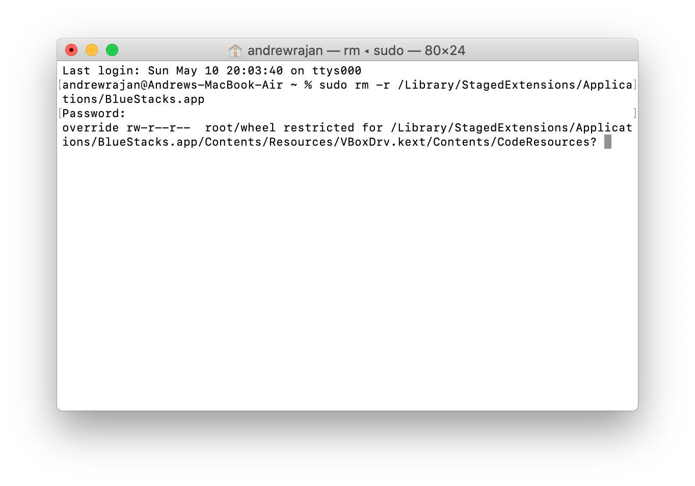

So I tried the sudo rm -r command and this is what I get. I'm not sure what I'm doing wrong but I assume I either didn't add appropriate commands or the spacing is wrong?
Add the -f flag or answer y to the question it’s prompting you and report back if it’s not working 🙂

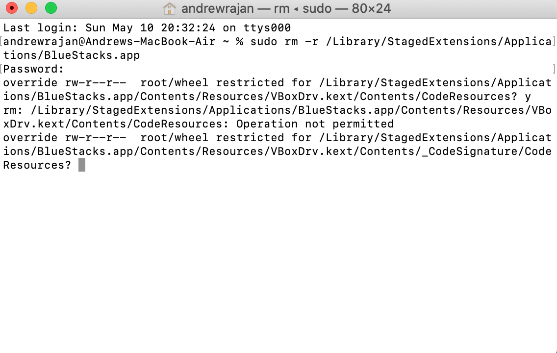

Okay so I pressed y and this is what I get. I only did it once for the screenshot but if I keep pressing it still says operation not permitted for each sequence.
Operation not permitted could mean that it's currently using them. Reboot first. Make sure none of these libraries are loaded by default. I can't remember how to do that on OSX.
The -f flag indicates to force removal. It can still fail, but it indicates that the shell process should assume a 'y' response to each of these queries.
