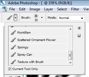

Looks like just a different brush with a lower opacity.
In the upper-left corner of the Photoshop, with your brush selected, you have the option to choose a different shape of brush. I'm not sure which one they used, but play around with a couple different kinds. Here's a pic.
Also, looks like they dropped the opacity, which can be done to the right of the brush shape menu, as I mentioned above.
I really wish the author of the video would have showed the steps outside of the actual drawing phase, such as the brushes, presets, options, etc. >_<
Okay, thanks for the explanation - perfect! Now, a bit before that, at around 0:12, how is she doing that, it's making it more "jagged", I guess, a neat brush? Settings?

Correct me if I'm wrong, but I see something different in this CS2 (on a Windows machine at work, blah) see the below attachment. How do I get what you see?

Right click the canvas or click on the brush to the right of what you already clicked on. Presets are never to be used for anything.
Go to window>brushes to select the things that the pen pressure controls, then click the lock so it locks the setting for all other brushes. Opacity jitter is turned off for most of the default brushes, so that one needs to be set to pen pressure under "other dynamics" and then locked (leave the slider at 0%).

What settings *should* I have? I have only Shape and Other Dynamics checked.
