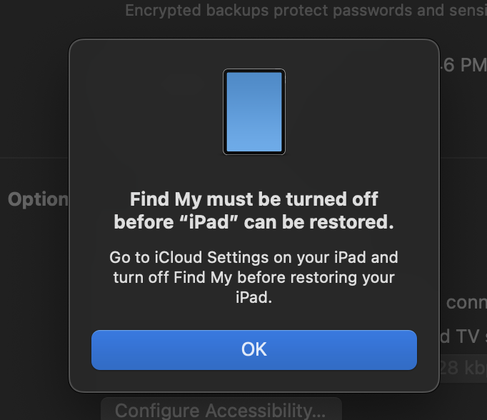

I tried “restore iPad” on one of my macs and got the below message. Catch 22.

If I remove the iPad from my account, will I be able to bypass the “remove FindMy” requirement?
