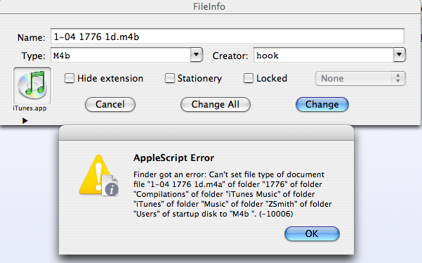

Well I wasn't able to get any change in the file to be marked as an audiobook. My goal was to be able to have the book read at the faster speed.
I selected my file...
I changed the .m4a to .m4b in the Name and Type section.
Clicked change and got the error message as expected. Clicked change again and the file is changed as shown in files A, B, and C, in the first picture.
I then updated my iPod in iTunes, but nothing appears to have changed.

Hmmm....Sorry, but I guess I can't be of any more help.:( I do exactly what you did, and the difference it makes for me is after the file is converted to m4b I can then put the audio book files on my ipod and they will automatically be put in the audio books section of my ipod. As far as playing them faster, I've never done that.

I have found that no matter how you change from M4A to M4B that you need to remove the file from iTunes completely and then re-import it.
Note also that the type can be case and whitespace sensitive so you should use "M4B " (the last character is space) instead of "M4b"

Is there any way of removing and re-importing without the original CD because that has already been returned. Would burning the copies I have to a DVD/CD work at all?
I also tried the "M4B " (mine hadn't been either capatilized or spaced). When I clicked change it gave me the error message, any changes I had made before didn't bring it up, but nothing seemed to change.
