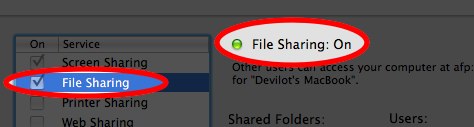

Make sure Sys. Prefs.> Sharing> File Sharing is checked off--- on both 'puters.
Then in Finder, you should be able to see it on the left hand side, under "Shared."
Click on the one you wanna access, Click "Connect As," log in as a registered user (have your name and p/w handy). Should see a list of Users on the "other" Mac. Go for it. :)

Sorry it doesn't work for you folks, but those are the steps I took and I can drag 'n' drop stuff from iMac to MB and vice versa.
