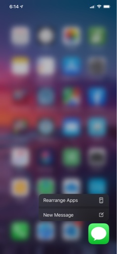

When I first got my iPhone XR I was able to use haptic feedback to quick reply to a text on the lock screen. I just updated to the new operating system and it looks like that was either removed or I need to turn it back on.
Please say it wasn’t removed. That was my most useful feature.
I’m having the same issue in my iPhone 11 Pro Max
This isn't what the OP is referring to. OP is talking about responding to a message on the lock screen.
Then use passcode to unlock. Same principle applies.
I appreciate you trying to help but if I’m going to have to go through the trouble of entering my passcode every time I want to reply to a text, why wouldn’t I just use the Messages app?
The whole point of using haptic feedback on the lock screen is to send a quick reply.
