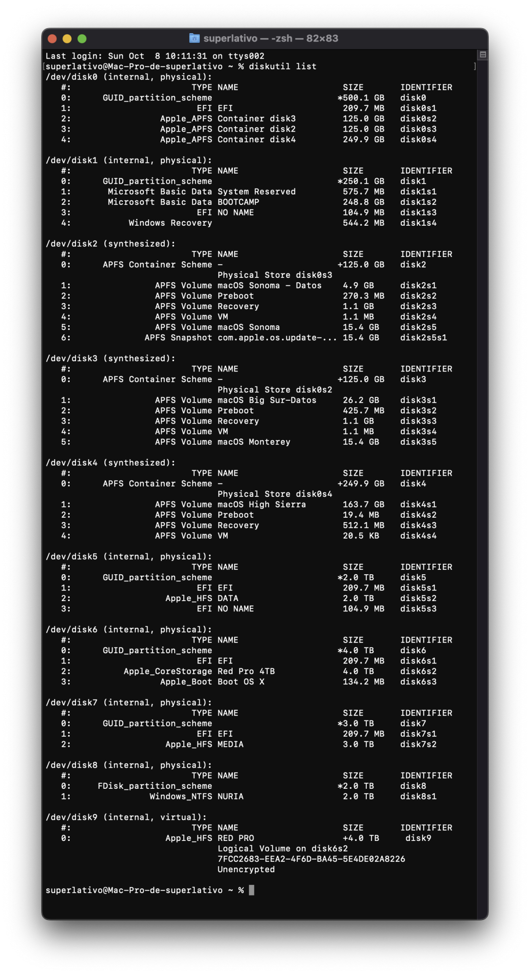

I attach the screenshot of my partitions*. I installed EFI for Mac Pro 5.1 on the disk0s1 partition. To make sure I checked the date and time of the files. It was right. As you can see in my list of partitions, I have three EFI on other disks because they previously housed some macOS, but with the purchase of the SSD they became storage and I never knew how to delete them. They have not given me any problems either and since they are not macOS disks I think that EFI should not affect them. Although it would probably be best to eliminate them.
Any idea why, even with the correct EFI, the prohibited symbol still remains on older macOS?
* NOTICE: in the partitions you will see Sonoma but it is yesterday's functional installation of Monterey. I named it Sonoma to differentiate it from the old Monterey.

I agree with you, that EFI won´t matter for booting. So I guess that your macOS Monterey (Sonoma) is broken somehow. To get some more info about the APFS volumes, you can use this:
Bash:
$ diskutil ap list
There is a snapshot on /dev/disk2s5s1. Maybe the snapshot is broken and prevents booting macOS Monterey (Sonoma). Snapshots can be deleted if you are sure it doesn´t contain important changes that shouldn´t get lost.

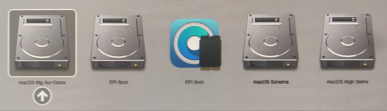

How I had lost the OCLP boot picker I remembered that the ATI Radeon RX560 card lost the native boot picker so I mounted the original ATI Radeon and my old Apple Cinema Display and I have partial access to macOS again. I explain.
Native boot picker:
macOS Big Sur-Datos > Monterey (Partial boot. It remains stuck at 35% of the progress bar).
EFI Boot > Windows 10 (Perfect boot).
EFI Boot > Shows the OCLP boot picker.
macOS Sonoma > New Monterey but shows a kernel panic screen and It instantly starts but also stays at 35% of the progress bar).
macOS High Sierra > Perfect boot.

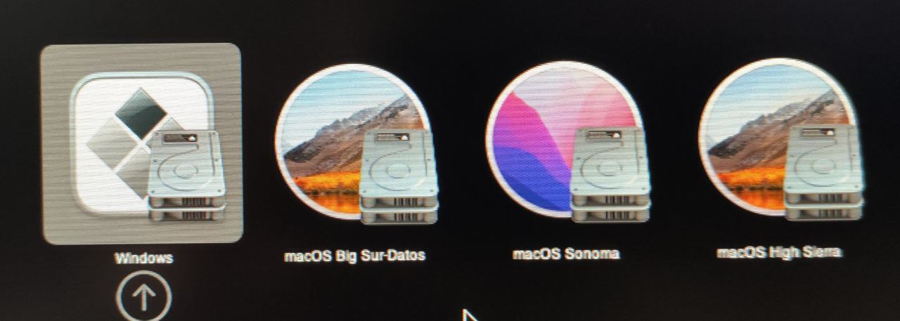

OCLP boot picker:
Windows > Windows 10 (Perfect boot).
macOS Big Sur-Datos > My old Monterey (No boot. Prohibited symbol).
macOS Sonoma > The new Monterey that I installed yesterday and booted without problems but today it does not start. Probably due to the NVRAM reset.
macOS High Sierra > High Sierra (No boot. Prohibited symbol).
