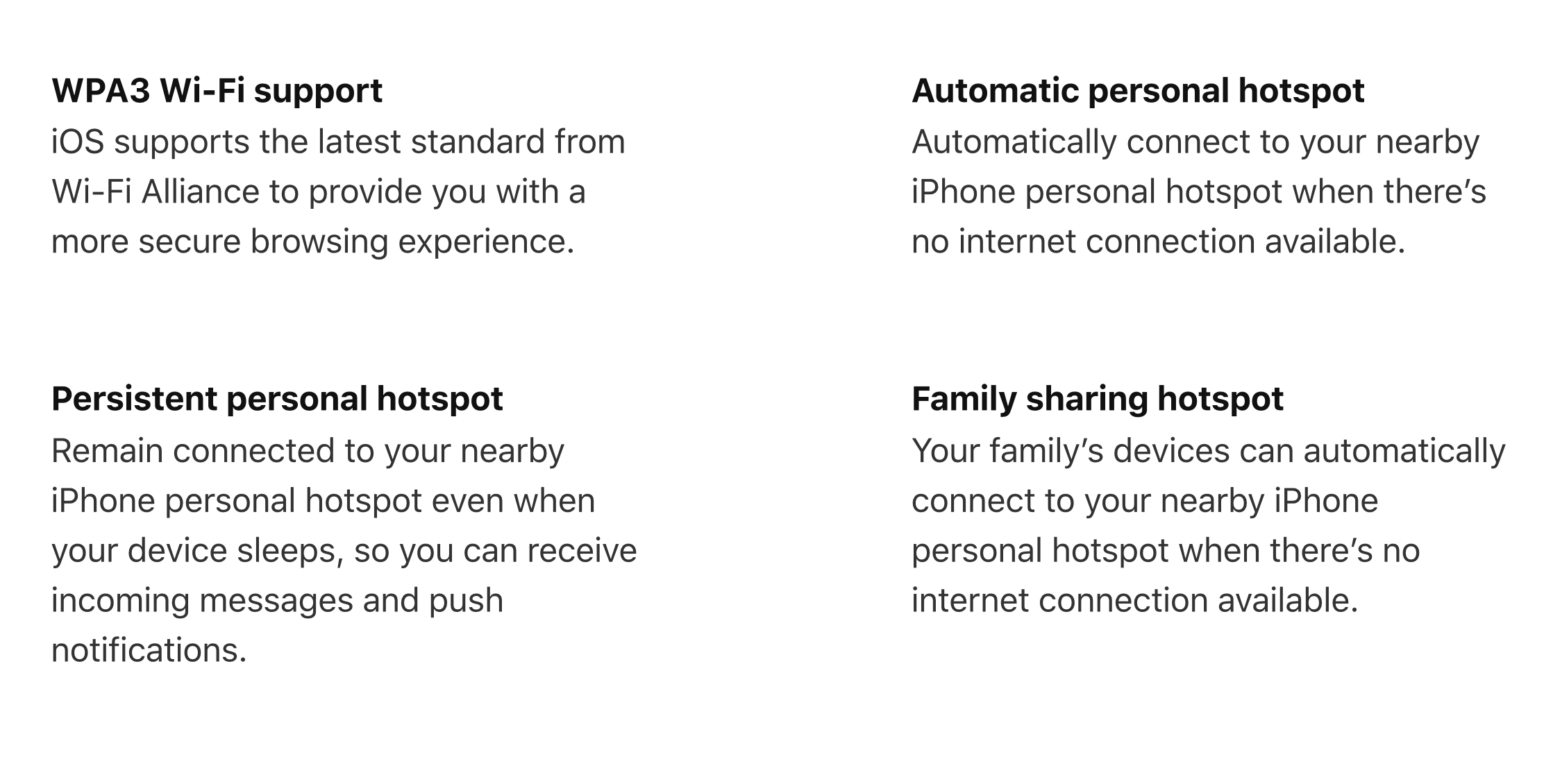

Anyone here with iOS 13 beta installed on their iPhone? Apparently there's a feature called "Persistent Personal Hotspot". I've been waiting for something like this on iOS for a very long time. So far all of the data points to the fact that it'll work perfectly with iOS devices. What about Android? If an Android device connects to an iPhone or iPad with iOS 13 with the "Persistent Personal Hotspot", is it still going to maintain connection with an iPhone/iPad when it goes to sleep?
This is really an iOS 13 discussion—not a iPhone 5 discussion from 2012.
Being said, yes, it’s a new feature.
