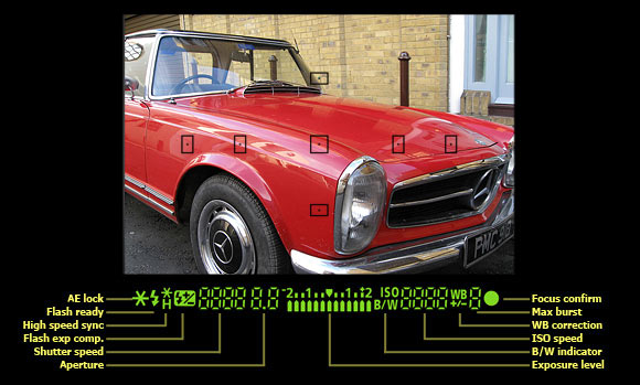

The bit that says "Exposure level". The indicator will be at the inverted triangle when the exposure is "correct". To the right of that means overexposed, and to the left means underexposed.
Picture courtesy of DPReview.com
gotcha, so would there be anything on my camera(Canon Rebel XS) that I need to look for to help get a correct reading?
not particularly. if you decide to use partial metering (your camera doesn't have spot), you'll have to draw out the metering circle on your own, though, since there isn't one in the viewfinder. it should be a circle that covers the area just within the four AF points surrounding the center.
remember that 0 on the exposure meter means the average value of the metered area will be neutral gray. if the area you're metering happens to be the same value as neutral gray, then 0 is properly exposed, to the right is overexposed, and to the left is underexposed...but usually that's not the case, and you have to use exposure compensation to correct for it.
