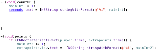

i will give you any info/pics of my code that you need to be able to help. with that being said it is a NSTimer that i am using for the score

skater618, here's a tip: Don't use images of code to provide code snippets. Use the
Code:
 tags. This makes it easier for other to see the code as well as provides an option for them to more-easily copy the code should they want to test something on their own.
