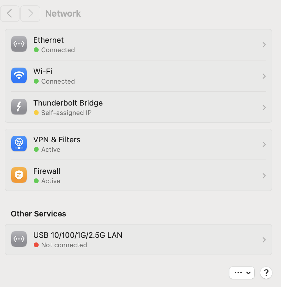

The indicator is always yellow. Shouldn't it be green?
When I remove the bridge or cable everything is the same. They seem to share data over the Router where both are connected via Ethernet or even (directly?) over WiFi when it's enabled. How do I know what is used for data transfer?

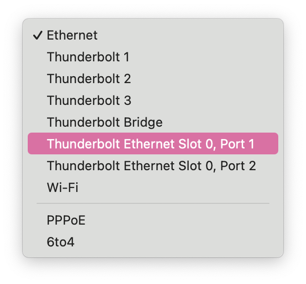

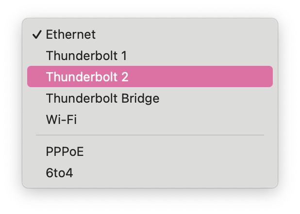

As permanent solution creating a service just for Thunderbolt 1, 2 or 3 simply instead of using the bridge doesn't do anything. Nothing happens when clicking on it only Bridge works.
Strangly the Mini has two other options, I used one with this 17.1.1.1 IP and even got a green connection without entering anything else. But that was red soon after I did whatever and never went green again, also not when created new.
I wanted to do the same on the iMac with the other 17.1.1.2 IP but the option is just not there and the others don't work only bridge is working for creating a new Thunderbolt service.

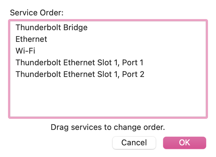

I appreciate the above post. I’m “helping” based on my Mac knowledge, but I don’t have any similar setup so I can’t test anything. I can only throw out ideas. I assume you are aware that the network interfaces are used in order from top to bottom, and that you can drag them into any order you want. I wonder what would happen if you put the Thunderbolt bridge at the top of the list. It might then be primary for Mac to Mac file transfers, while Internet access would be taken care of by a lower interface such as WiFi or Ethernet.

Thanks I didn't know that. I didn't know anything about Networks until I wanted to try that Thunderbold Bridge. I didn't even know I can just establish a Network connection between two Macs with two clicks in Finder, when both are via Ethernet and maybe also just WiFi on the same Router. Then I just did a little research.
I had disabled WiFi and Bluetooth before and turned it on again recently because of Universal Control.

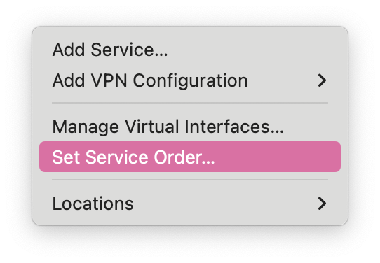

I could drag anything in Network Settings, then I found what you wrote it in the three dots, somehow I never saw that option before.

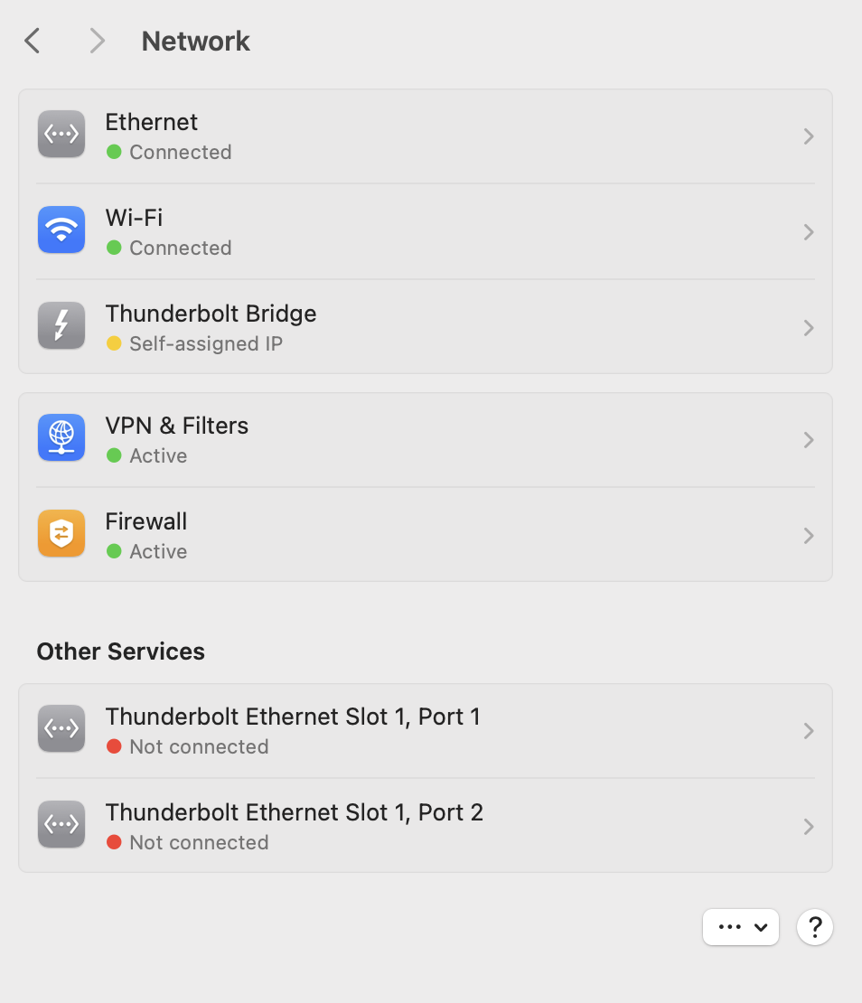

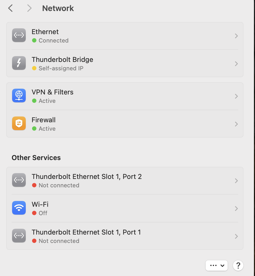

But out there everything stayed the same:
Nothing changed. :( I tried copying a 5GB file and the speed is max. 100MB per second, what indicates a 1Gbps connection.
Maybe that order is only relevant for Internet connections.
I then did a reboot but it did not change the order too. In Terminal those en numbers for the Ethernet ports/connections also did not change. It's still en3 on the mini and en2 on the iMac.

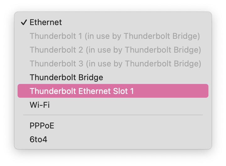

I just found out, the new order only affects the services that are offline. And also found out that this Thunderbolt Ethernet becomes active when I use the Ethernet port of my Dock. I just wonder why there are always two and I can create a new service with those when I delete both.

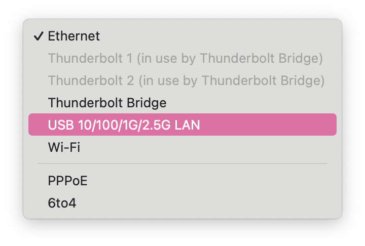

My other TB4 Dock that even uses two connections on the iMac is just displayed as USB LAN:
Now ALL TB ports on both Macs are greyed out and in use for Thunderbolt Bridge when I click on new service and it seems there were just two Dock on the mini had been there twice because it was connected to another port before. But I had always two to choose for creating new services before I deleted both.
Those now greyed out before were just useless, when clicked, simply nothing happened.
