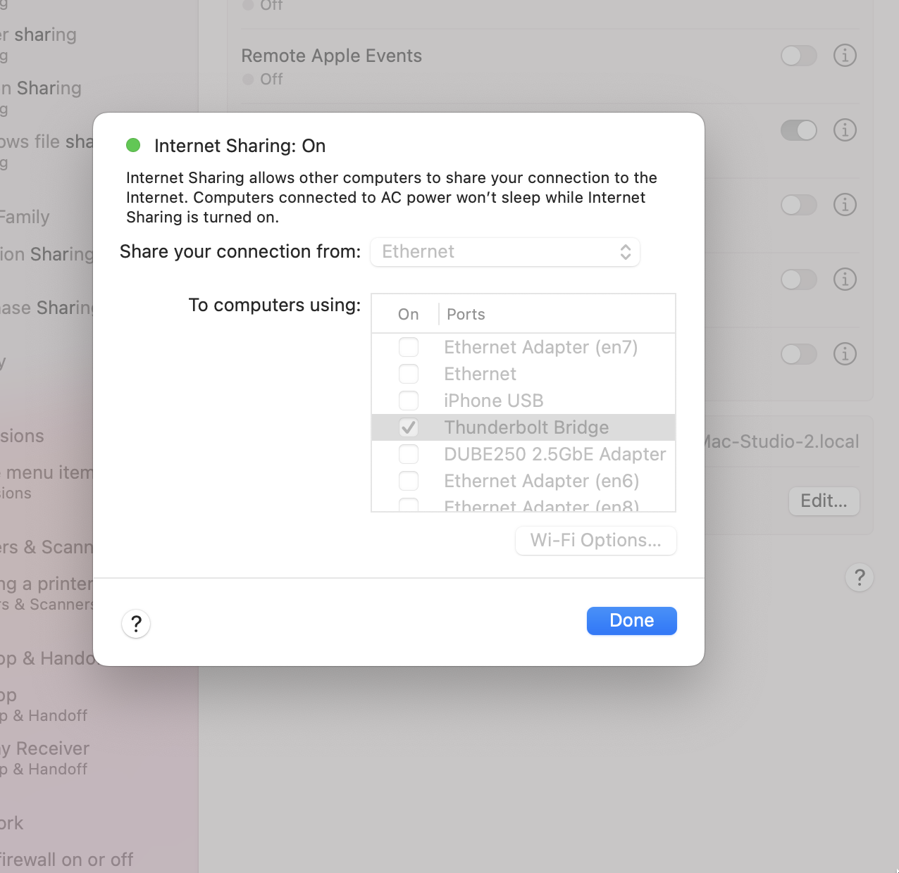

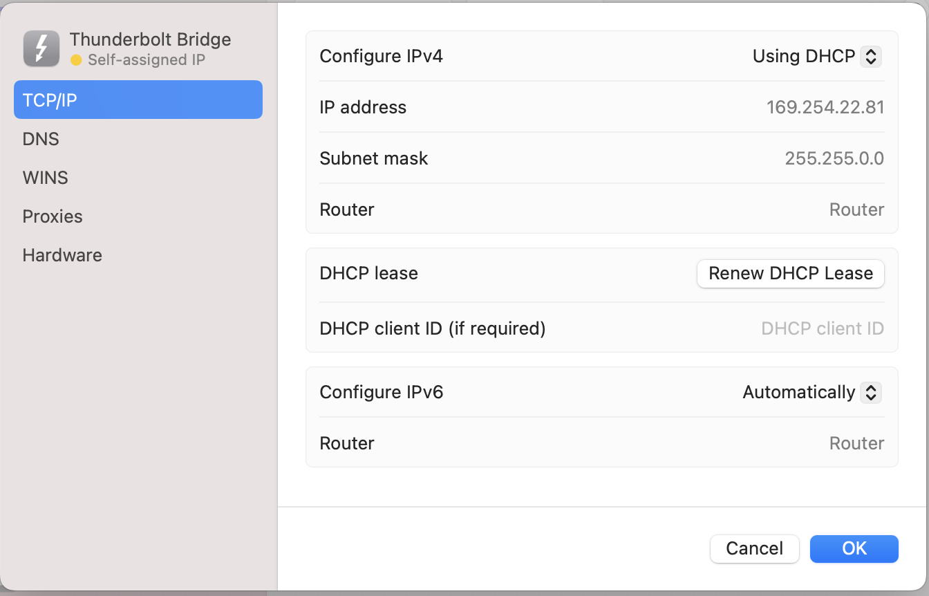

I have a Mac Studio, and 5Gbps internet service. I'd like to share this via Thunderbolt to my M1 iMac.
I have configured the Mac Studio to share internet via Ethernet via Thunderbolt Bridge:
However, the receiving iMac doesn't recognize, only showing Thunderbolt Bridge in 'Unknown State'. I've tried different cables, this is a config/software issue.

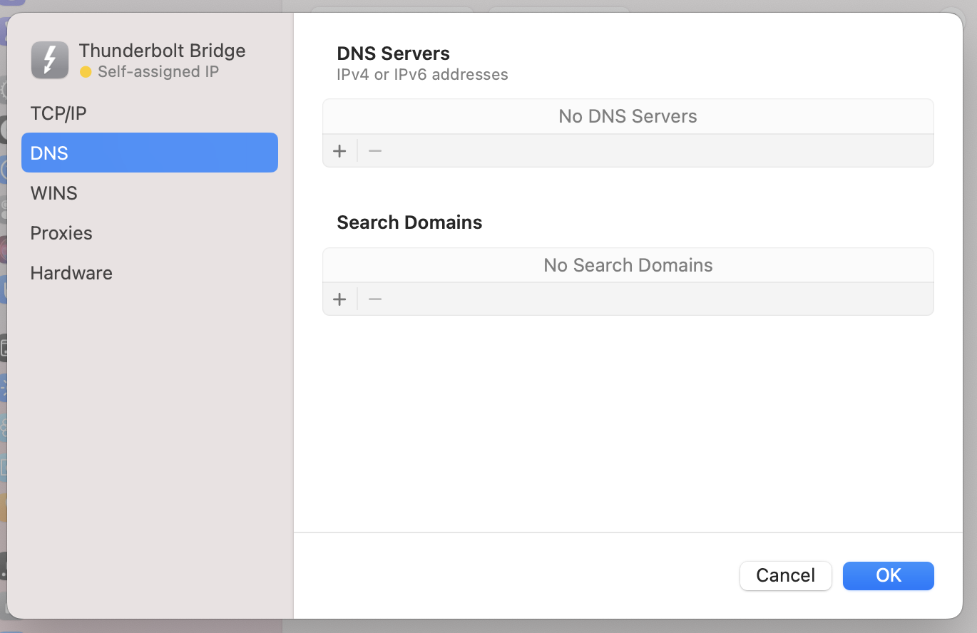

I suspect you need to use manual addressing on both machines for this connection within the subnet and IP range of that provided by your ISP router using DCHP. Also make sure the DNS servers have valid entries. If you need to put something in then 8.8.8.8 (google DNS would be OK)
What does it say under TCP and DNS on the screen above.

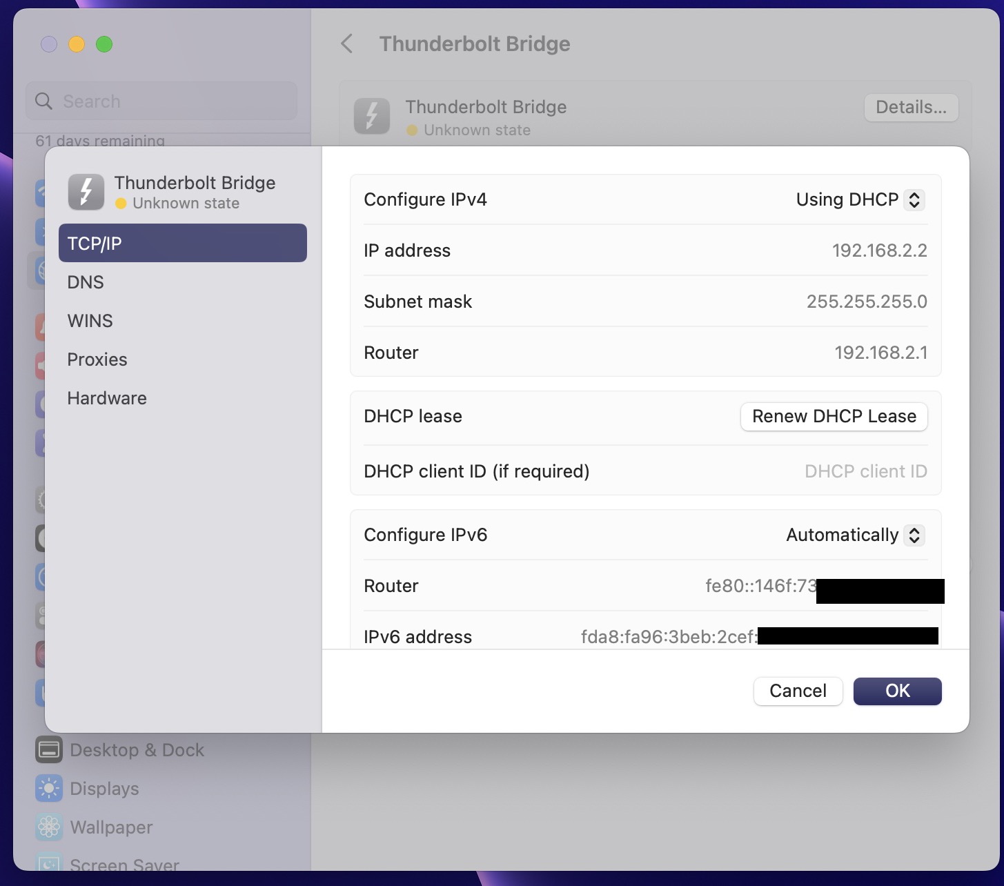

Thanks. I was expecting the DHCP to happen automatically. Please see below:

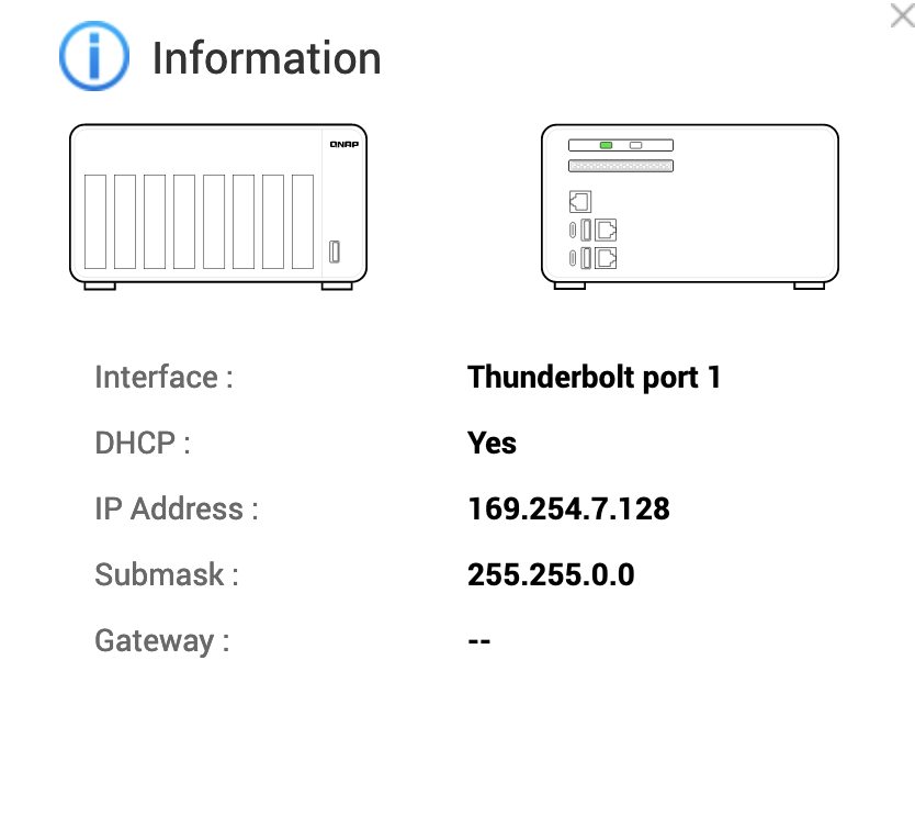

I run a thunderbolt connection to my NAS which give it internet access. Home ethernet network is 10.0.0.0 mask 255.255.255.0 router 10.0.0.1. Internet sharing is off.
On my Mac Side I have:
On the NAS side
Maybe this will help.

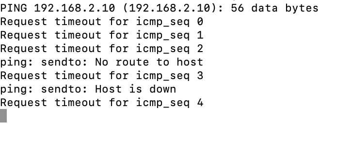

Try this:
ping 192.168.2.10
ping 192.168.2.11
Let us know what the result is?
Please see below:

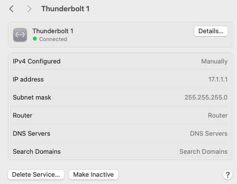

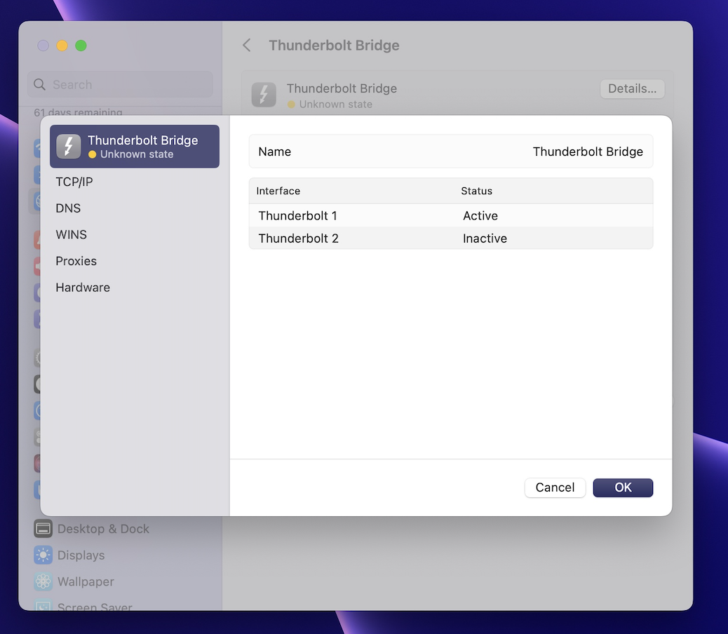

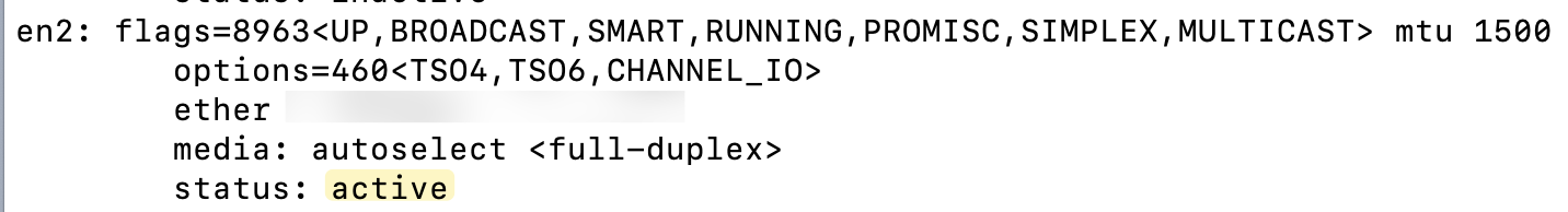

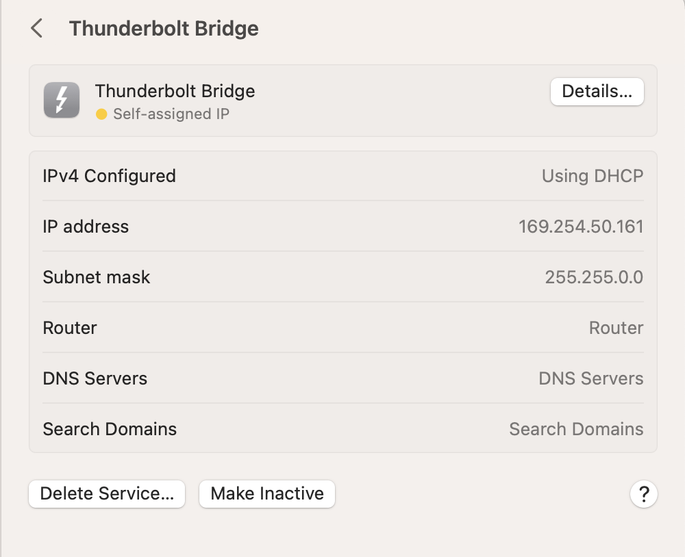

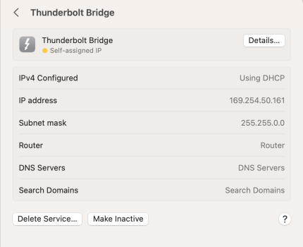

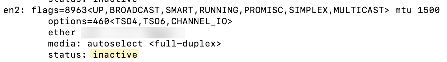

This sounded like an elegant solution and I tried it, but the Terminal command didn't work—not sure why, but after rebooting, I was unable to successfully ping.
As you can see from the screenshots, en2 appears to be "active" on one device, inactive on the other. Just FYI, the Mac on which it's "active" is an MBR with no ethernet port or adapter, and the one on which it's "inactive" is a Mac Studio with ethernet. I tried to delete the en2 interfaces, using two methods I found online, but neither worked:
"ifconfig en2 delete 17.1.1.1" returned error "ifconfig: ioctl (SIOCDIFADDR): Can't assign requested address
"ifconfig en2 0.0.0.0" returned error "ifconfig: ioctl (SIOCAIFADDR): Invalid argument"
Lastly, I'm unable to create a new "Thunderbolt 1" (or 2, 3) interface—I select it, but no new interface shows up in the list. I am able to create a new Thunderbolt Bridge, however.
Would so appreciate any help—thanks!
