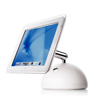

I have a 2002 "pedestal" Imac like the one in the attached picture. I just got a wireless internet router and I would like to be able to wirelessly connect to internet. What is the best thing to get for my Imac to make it wireless? I'm more concerned with connection speed than cost.
Thanks!

iMac G4 Wireless
Yours is an iMac G4.
Because there are several versions of the iMac G4, with different wireless cards I'd need to know which it is before continuing.
You can find out the model by entering your serial number here:
https://selfsolve.apple.com/GetWarranty.do
(Click Apple Menu --> About this Mac --> More Info and your serial number will be displayed on that page).
It should say something like iMac G4 (Flat Panel).

Thanks. I entered the serial number and got this:
~VIN,iMac (17-inch Flat Panel, 1GHz)
Is that enough info?

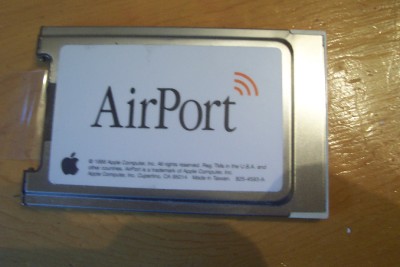

So I just bought one of these.....ORIGINAL APPLE WIRELESS AirPort CARD 630-2883/C. It should work right? Is installation difficult? I'm assuming I just get inside the imac through the plate on the bottom.

^^ Looks like the one out of my powerbook I think the ones that go in iMacs are a lot smaller

Admittedly I should have researched more before I bought this card, but I think I may have gotten lucky and purchased the right one. Reason being is I found installation instructions for my Imac on the Mac website and the card in the pictures is the same one I bought:
http://support.apple.com/kb/HT2993
OK so I opened up my Imac and took a look at the slot where the card is supposed to be installed and I think maybe you guys are right. What I actually need is an Airport Extreme card. Will that work with my wireless router or will it require that I buy an mac airport station to get internet to it?
Ooh, ouch. Yeah, the older G4 iMacs used the card you bought--the expensive, hard-to-find "regular" AirPort card. The later ones--which you appear to have, if it's a 1GHz model--use the newer, relatively easier to find, and faster AirPort Extreme card.
That's kind of on ziggyonice, although it's an understandable mistake--I'd forgotten that the later ones used the newer cards myself until I checked EveryMac. An article, for future reference:
http://www.everymac.com/systems/app...imac-g4-how-to-upgrade-airport-bluetooth.html
As for the issue at hand, yes, if you get the correct card--the Airport Extreme one pictured--that will definitely work with your wireless router. Wireless is, thankfully, standard, so regardless of the model/manufacturer of the router your iMac will be able to connect to it. You'll also likely get all the speed necessary out of said card; if you have an "n" router you won't be able to connect at maximum speed, but unless you're transferring data from one computer on the same network to another even "g" wireless will be far faster than your internet connection.
Bottom line, get the right card and you're in business once it's installed and the antenna cable is plugged in (harder than it sounds--I'm surprised at how easy it is to think you've got it connected when it's not quite fully in). The good news is the resale value on those old AirPort cards is very good, since they're the only wireless option for older G4 iMacs and older iBooks.
