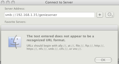

Hi thanks, I did try that and get the error message that the URL syntax is wrong; but i've attached a shot which shows it's correct. I still get the same message if I type only the smb://000.000.0.00/ portion of the URL
I can ping the volume from the console without problems.

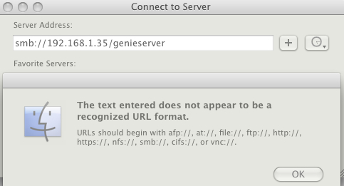

Thats really weird that it would give you that error since smb:// is what you are using, but says isn't found. hmm...
The fact that the error you're getting is saying that isn't a recognized URL scheme, when it certainly is, indicates that this isn't just a "can't see network volume" issue--it's something else going wrong. That is, it's apparently coughing up an error on a perfectly valid SMB URL, so the request to mount the drive probably isn't even getting to the point where it actually does anything.
As for why, I'm kinda lost--attempts to mount smb:// URLs work as expected on my 10.5.2 MBP and a 10.5.1 G5 tower as well.
Did you install 10.5.2 from the combo updater? If not, maybe try downloading that and reinstalling it. At least in some situations, that can help with odd problems.
Also, you might try creating a new user account and see if it happens there too--sounds like it's probably not a preference-level issue, but on the off chance it is it's a quick test.
