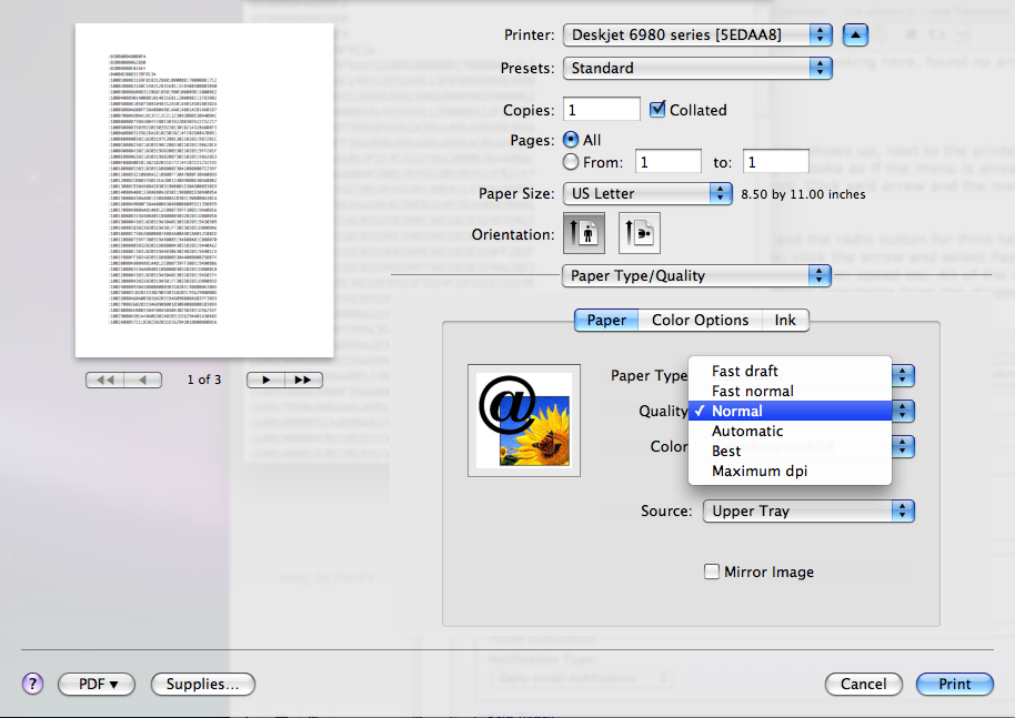

From the Print Dialog Box: Select Print Settings from the Drop Down Menu > Mode: Advanced > Quality: Draft.

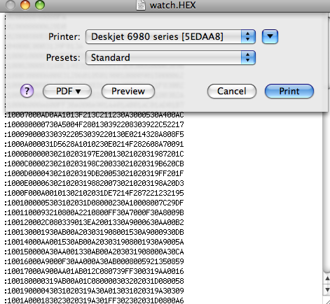

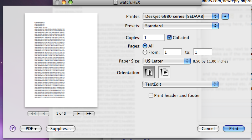

When you click print and the dialogue box shows up, next to the printer theres a little down arrow, slightly misleading at looks as if the menu is already expanded... contrarily... it actually is not. Click said arrow and the menu will expand.
Located between the orientation icons and the radio button for Print header and footer, you will see a selection box, click the arrow and select Paper Type / Quality and then select your options for printer speed etc. All of the options for printing are contained within the options selectable from the dropped menu.

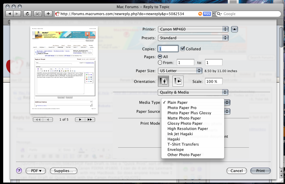

If Fast Draft is like a "Quick Print" sort of thing, I need help too. But I have a Canon PIXMA iP1800. I can do it on my Lexmark printer, but it isn't compatible with my MacBook. So does anyone know how I can Fast Draft or Quick Print with the Canon Pixma?
well i tried following your instructions but it doesnt look like my printer supports draft mode under osx.
I have a Canon MP640 (it's a photo printer) and I don't have anything like that either.. do any of these options save ink?

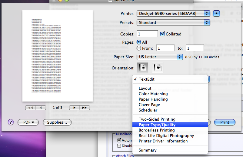

Thank You!
