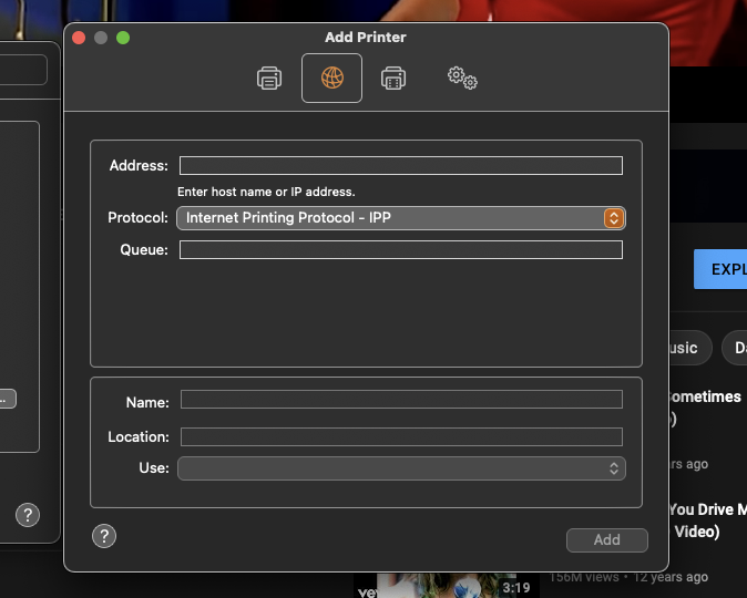

I've installed the Canon MP280 drivers for both macOS Monterey and Windows. I'd like to print from the Mac to a Windows PC's printer that's networked but I can't even though I've successfully added the printer to the Mac using it's driver using the Windows option, the last one in the screenshot (theprinter is plugged to the PC via USB and the PC is plugged to the Fiber box via ethernet. The Mac see the PC and printer via Wifi. All sharing settings on the PC is enabled).
I'd like to try adding that printer using IP but which protocol is the best for the Canon MP280 (it doesn't have Wifi nor AirPrint built-in) and what other settings do I put in the IP window for me to be able print to the networked PC printer?
Thank you. God bless, Rev. 21:4

Use what works (try all the choices)
(I know, it's not really that simple - but I also understand that it can get frustrating when things don't work as you expect. Take your time, find out what does NOT work, and finally, you will hit on the right setup.)
If you can see the printer - and it is listed on your Mac printer pref pane (however, your screenshot does NOT show that the printer is visible on your Mac), but you can't add the printer - it's quite possible that the Canon printer software on your Mac does not support a shared connection to your Canon MP280. That would be a software problem, and it's a Canon problem - not a problem with your Mac.
This Apple support article has all the info that you should need to connect to a network/shared printer.
Also, keep in mind that your printer is NOT a network printer - it is "shared" on the network. Not all printers can do that.
There's also the possibility of adding a print server to your network, and using THAT to share the printer on your network. You would connect your printer to that print server, not your PC. It's another choice to get you all connected and printing.
Another choice would be to move on to another printer that actually supports a direct network connection. Many printers have built-in Wifi, which would end up making this process super easy.
Reactions: Alvin777

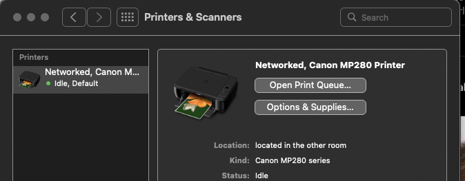

Hi thanks again. I've actually added the printer using the Windows one (the icon on the right most side) although it says it's successfully added (has a green checkmark), it doesn't work. I'll try the IP one, the icon with the globe, going through it's many protocols, I hope one works (I think it needs the IP of the printer as well which I think is the same as the IP of the PC- using ipconfig). Pray and fast it's the IP one works.

hmm... It looks like the printer is actually available.
What do you mean that it doesn't work?
Do you get some kind of error when you try to send a document to the printer?
Or, does the printer simply not respond at all?
What happens when you open the Print Queue, then choose Test Print from the Printer menu?
Does anything happen at all - error message, or even a blank sheet of paper is ejected from the printer, or any other kind of response?
Reactions: Alvin777

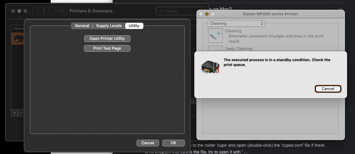

Hi. on the Mac side it says the printer is in standby mode even though the printer is On, then there's nothing in the print queues on both the Mac and the PC. I wonder if Monterey is not compatible yet with Windows 11?

I am not sure what you mean by "standby mode".
Does the Printers & Scanner pane say the printer is "Idle"? That would be normal for any printer that is not actually printing.
So, open your System Preferences, then the Printers & Scanners pane.
Click on your printer (it should be highlighted now), then click the "Open Print Queue" button in that printer pane.
The print queue should open. From the top menu bar, click the Printer menu, then choose "Print Test Page"
What happens then? Does the printer do anything at all? Do you get an error message of some kind?

Although macOS Monterey can see the Windows 11 printer, it displays this (it should be working by this time, shouldn't it?):

My search shows that the print process is in a "pause" or standby. Maybe you have a job that you tried to print but you canceled it before it could print.
Try double-clicking on your printer (in the Printers & Scanners window). You should then see the same Print queue window, but might then show a canceled print job that is forcing the printer to pause. Delete any jobs that you might see in the list. Click the "Resume" button in that window. It's the icon in that window with a triangle inside a circle. It will change to what looks like a " inside that circle. Your printer should be able to print now.
If you still can't print - in the Printers & Scanners window, right-click on your printer, and choose Reset Printing System. that will remove all printers, and their associated jobs. Then, re-add your Canon printer to that pane. THAT should fix it.
