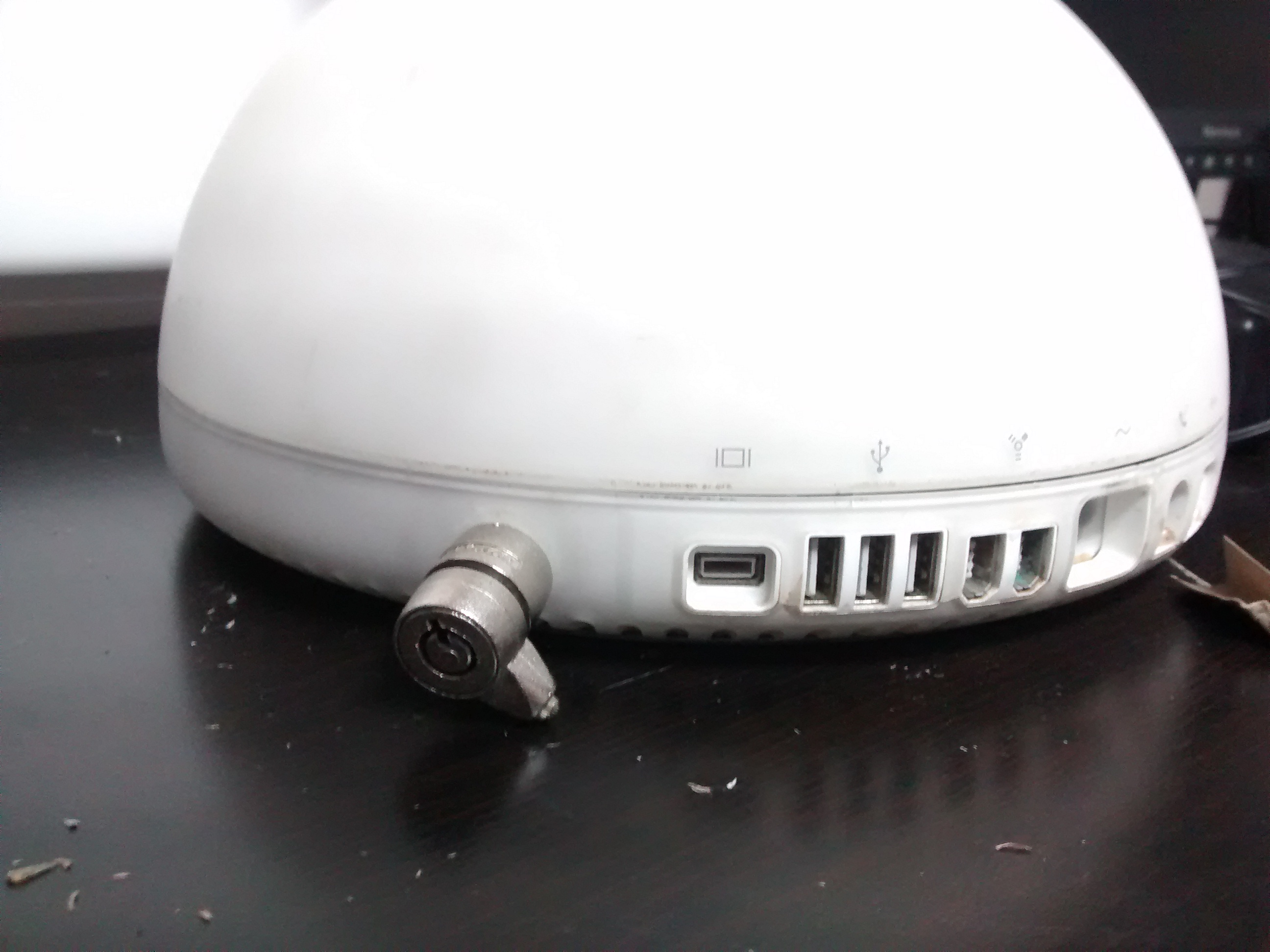

Hello all,
I owned this iMac G4 for two years now, and when I bought it, it had a Kensington lock, whose wire was cut, that I couldn't remove. I tried recently again since I wanted to perform a full clean-up of my computer, but I still couldn't do it. I tried using the cardboard technique, tried to use a flat screwdriver, nothing worked, even trying to remove the thing from the inside of the iMac failed. I even tried a Kensington key I found from someone, but it wouldn't fit, I assume because they're all slightly different. I could try and cut the whole thing somehow, but I'm really afraid to damage my computer. Any tips? Thanks.

Could you please post some pictures so that people here can get an idea of what you'd have to do?

Here:
Alright, so we pretty much just cut the lock straight in half using a grinder wheel or whatever, and it worked just fine. After two years, my iMac is finally free from his prison :D ! Thanks.
