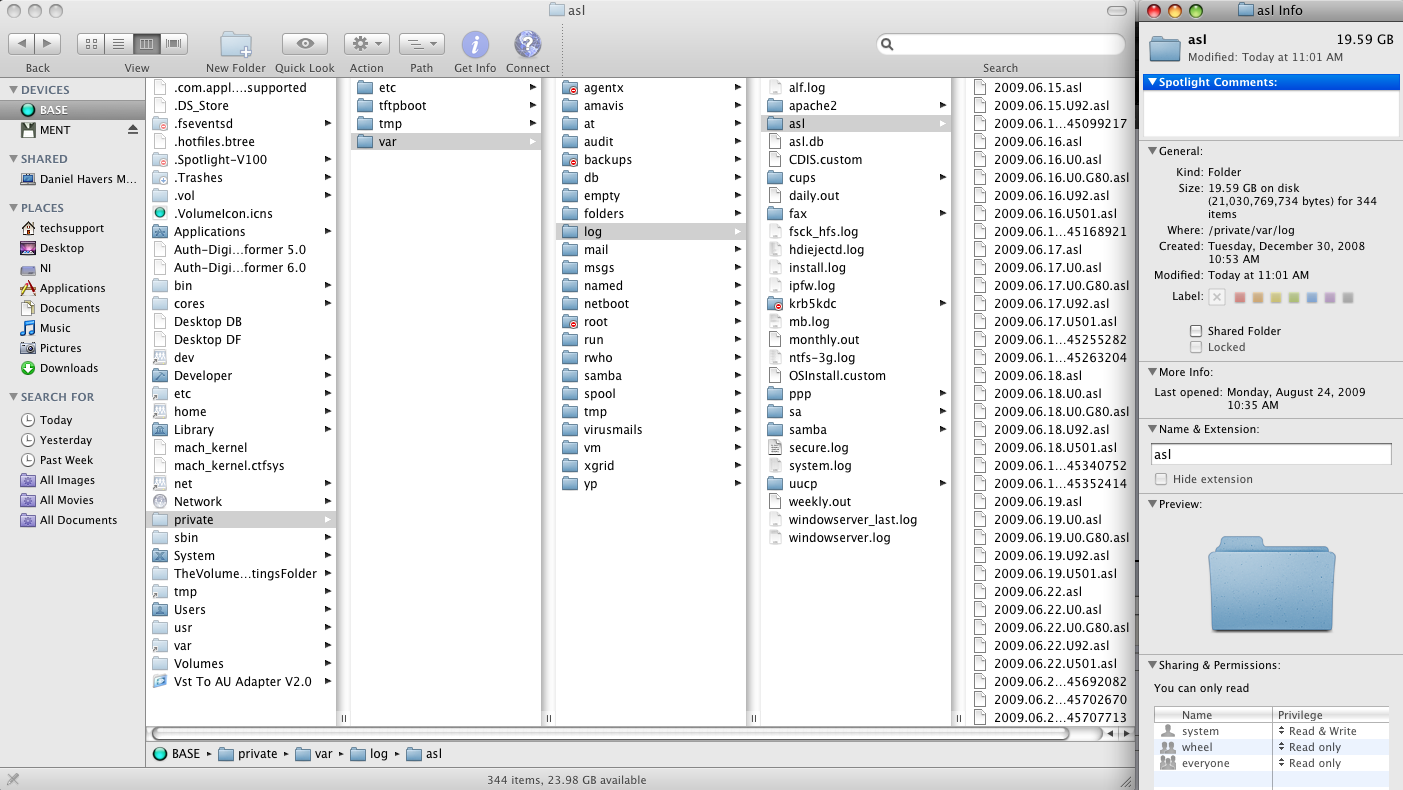

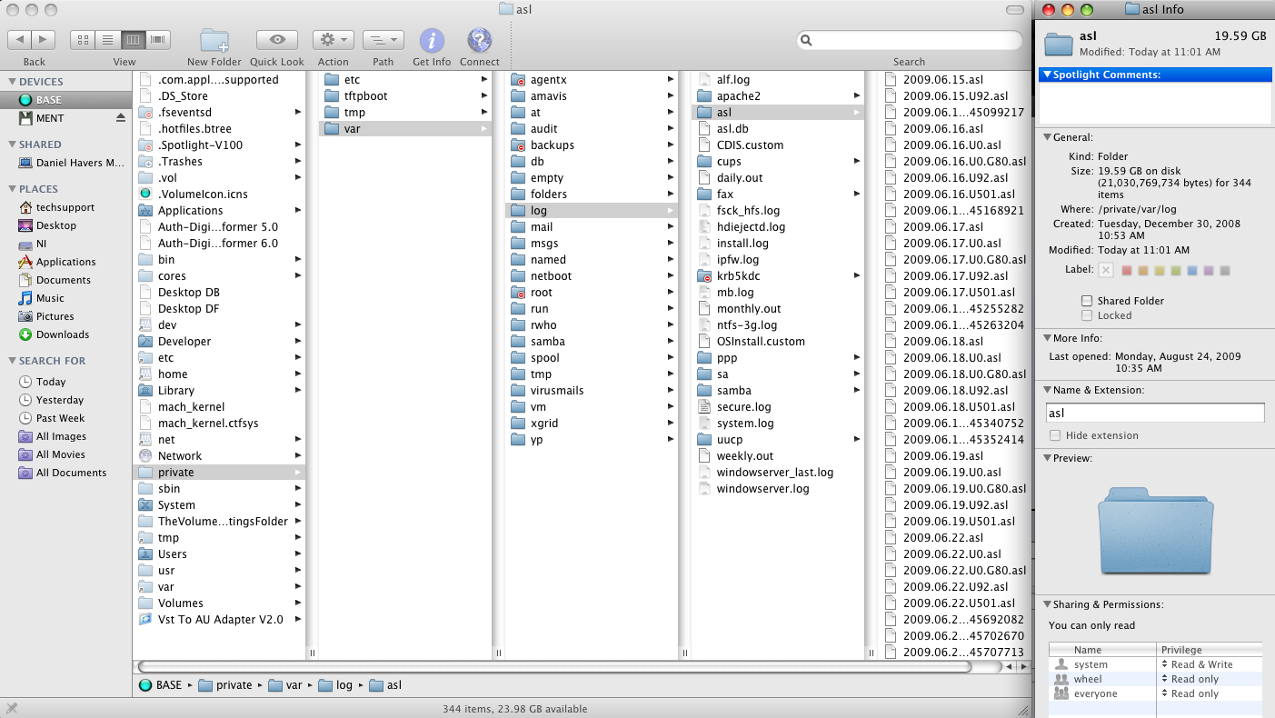

I have done a search in these hidden files and found that the folder private/var/log is consuming 20 GB on my drive. I've tried clearing and deleting the logs using cocktail but these log files are still taking up all that space. IN particular it is the subfolder ASL that contains these .asl files which are eating up GB worth.. Are these files safe to delete manually or will that fry my OS??
i've attached a screenshot so the folders/files mentioned can be seen.
mac mini 1.83 GHz
OS 10.5.8
80GB harddrive
2GB RAM
