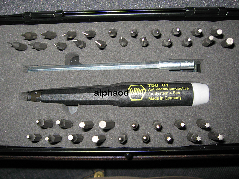

Wiha picofinish P26 #00. It will get any laptop philips screw out at any angle, even if it's threaded. It won't crack, and you won't lose your grip on it, if you need to turn really hard.
Good tools are more important than the length or any nonsense like that.
iFixit knows nothing of this, they make people open the entire MBP and remove the display assembly, to get to the two screws on the bottom of the display assembly because their tools do not allow them to properly insert or remove screws at an angle.
Once you use good tools, you'll never go back. Your work won't leave marks in the screws anymore. You'll work faster. You won't lose screws.
$5 on a good screwdriver is a good investment. Throw the screwdrivers that come with parts/guides/free promotional things are trash, do more harm than good, and should be disposed of ASAP. Same for just about any generic "electronics kit screwdriver set", they are machined horribly and shed very quickly.

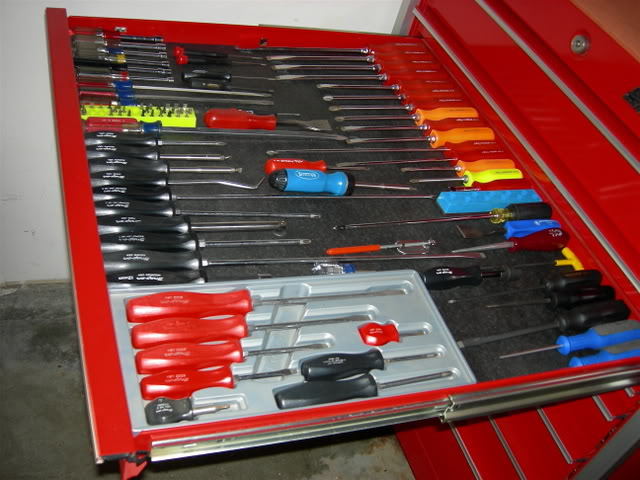

Who you tellin'? You wanna see may screwdriver drawer? 😛
