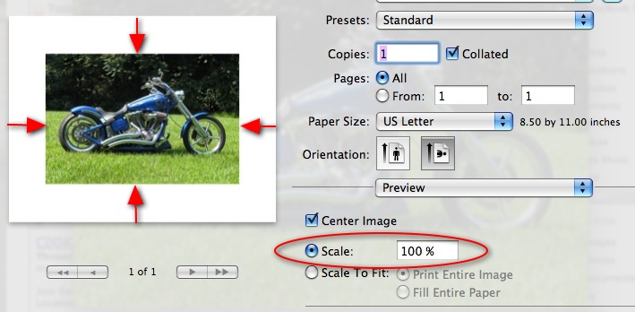

Open the image in Preview. When you choose "print," you'll have an option to scale the picture by the percentage of your choice. That may be the easiest method for you.

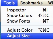

this is not working. I opened in preview and went to tools clicked on adjust size, typed in 2x3 clicked ok and saved it. I didn't print it through print preview cause it doesn't let me choose my paper size and what kind of paper so I open it through photosmart studio cause i can choose paper and type. Did that and the picture came out being a 4x6. I'll try again later.

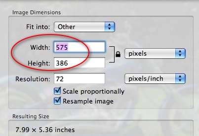

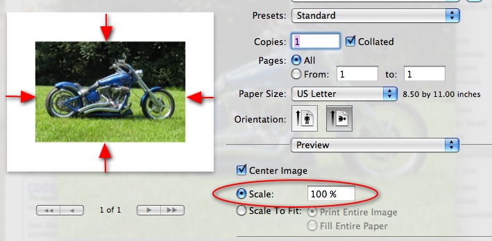

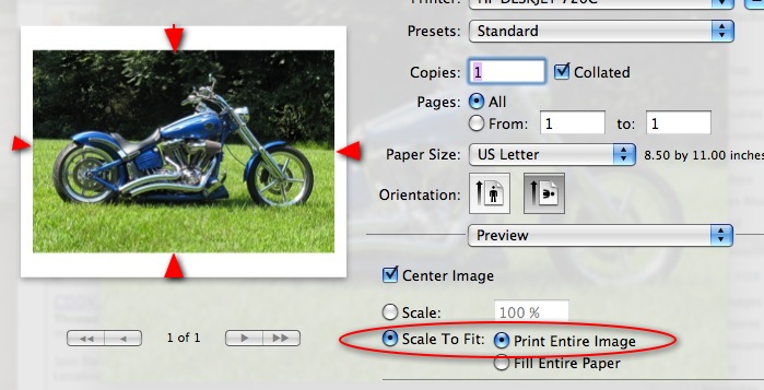

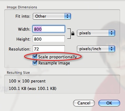

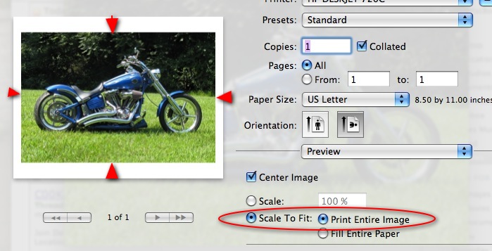

It sounds like you need to check to make sure Photosmart isn't resizing it in your print preferences. If you resize it using Preview and save it, your changes should still be there. You can verify the changes have been saved by locating the file in Finder, right-click on it and "Get Info". Under "More Info" you should see the dimensions. If they are as you want them to be, but the photo prints with a different size in Photosmart, then your print settings in Photosmart are most likely the culprit. Have you tried printing it from Preview, instead of using Photosmart?
Finder > right-click > Get Info:
Preview > Tools > Adjust Size:
Preview > Print > Scale 100%
Preview > Print > Scale To Fit:

You keep saying "preview" instead of "Preview", which leads me to believe that you're not following my instructions. I'm referring to "Preview", the application in your Applications folder, not your print preview in any other program. That's why it's capitalized.
^^^Yeah that's what I'm talking about. I went to that, but when I choose "print" from Preview in the applications I don't have the options like you. The ones you posted for size and everything else. When I open it through photosmart studio and select "print" I have those options. So I don't know what's wrong.

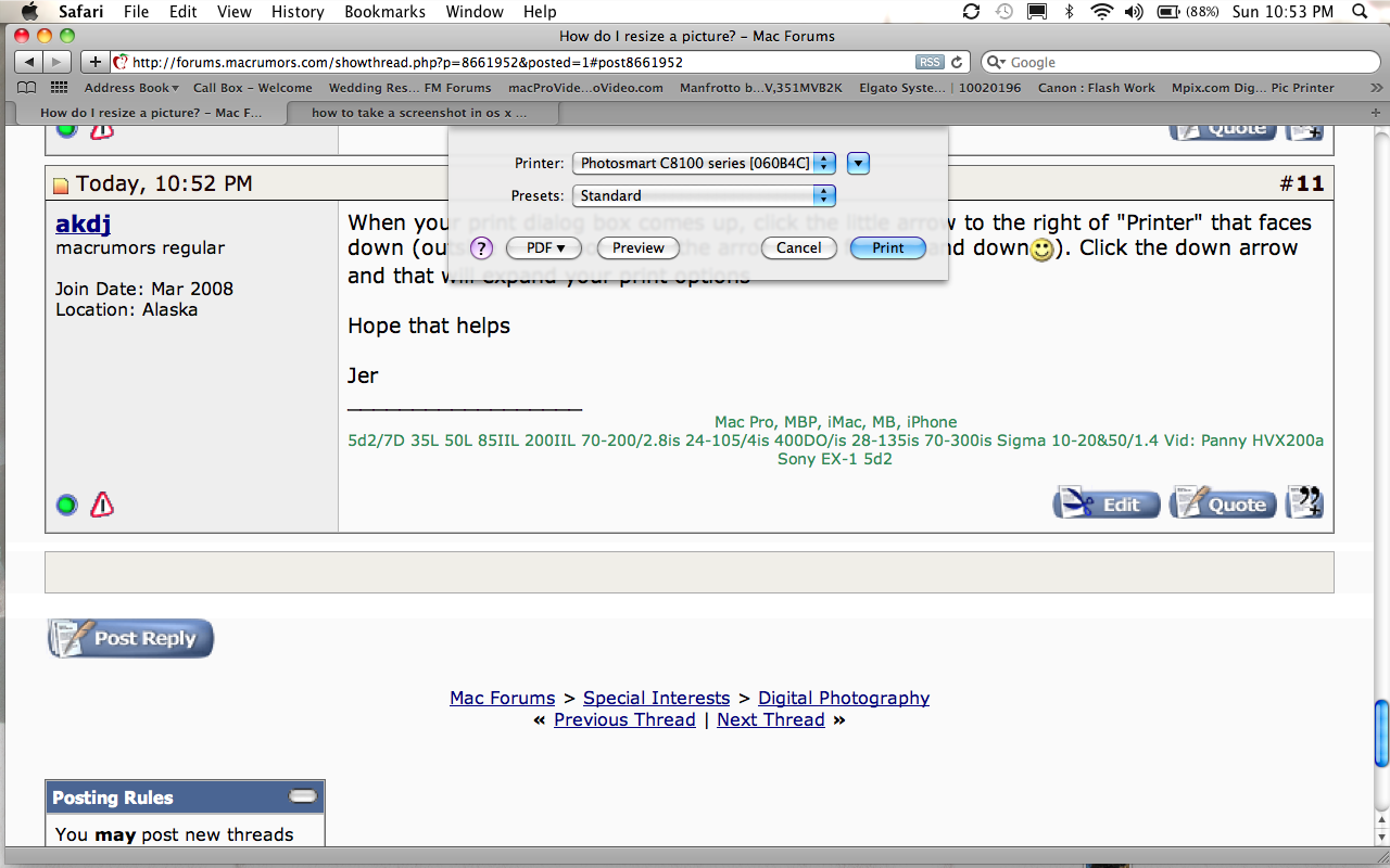

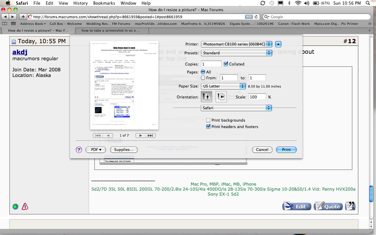

When your print dialog box comes up, click the little arrow to the right of "Printer" that faces down (outside of the box, NOT the arrows that face up and down🙂). Click the down arrow and that will expand your print options
Hope that helps
Jer
Check out this screenshot and you'll see the little down arrow I'm talking about
Just to the right of Printer top line
Then, this will happen

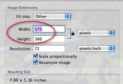

Thanks akdj. That did help, but my issue now is the picture comes out being 3x4 and I wanted a 2x3. When I enter the width and height I am able to change the width to 2 and the height automatically changes to 1.41 inches. I am unable to change the height without the width changing. Also on the preview from the "Preview application" the pic looks the same size (3x4) when the picture was saved at as 2x1.41 inches.
It’s going to scale the image proportionally so you might want to check the original image size because it might not be a perfect 4 x 6 when measured. Also, you could drop the photo into a program like Photoshop or gimp to resize and crop exactly to the dimensions you want.

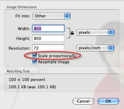

GGJ I unchecked the box and it was able to stay at 2x3 inches. When i saved it as that the picture seemed to stretch for some reason. In print preview form "Preview" applications the picture almost took up all the space on the 4x6 paper and it should be this tiny pic😕 The original picture was 3x5 1/2, which was scanned if that matters.

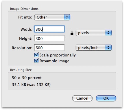

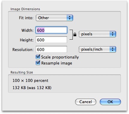

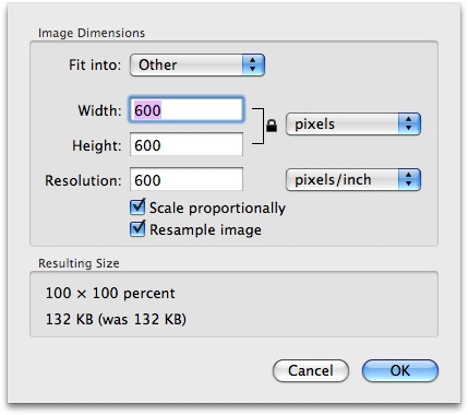

OK, starting with an original picture, at 600x600:

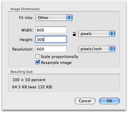

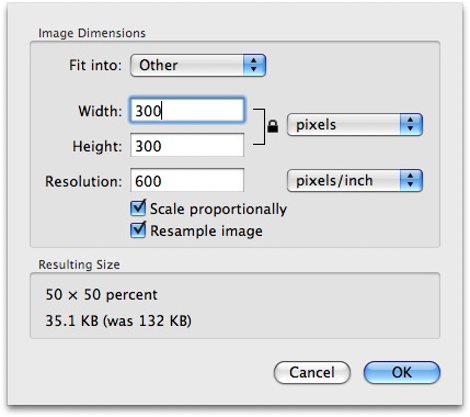

If I resize it, scaling proportionately:
It comes out 300x300:

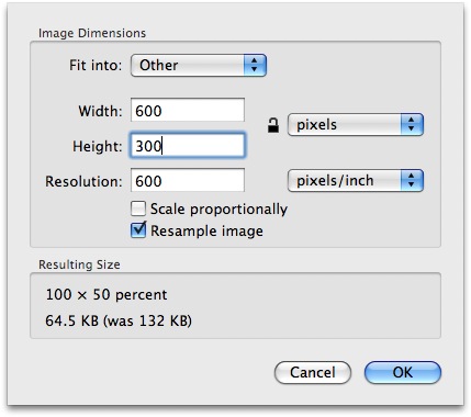

If I resize it, without scaling proportionately:
It comes out 600x300:
It just depends on what you're trying to accomplish. You can resize, proportionately or not, crop, and do many other modifications with the Preview app. Either you're not adjusting the size of the picture correctly, or you're not selecting the right options when you print. If you use the software correctly, you can do most basic image modifications with Preview.app.
