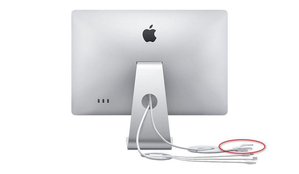

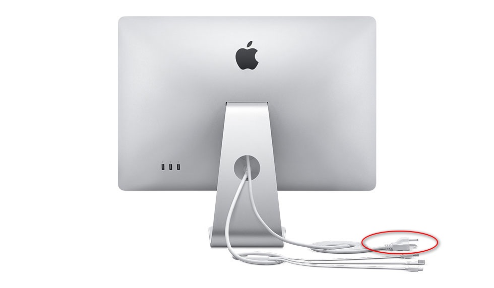

I've got the DVI hooked up, it's the AC cable I'm confused about. I didn't get one when I bought it. But also, I'm confused as to where it connects. I'm using a Macbook Pro and the cinema display looks like this -
As you can see, there's nothing that plugs into the wall. If you look at other models, you can see a second cable coming out of the back of the display that goes into the wall -

On taking a second look, you posted pics of two different displays. Which model do you have?

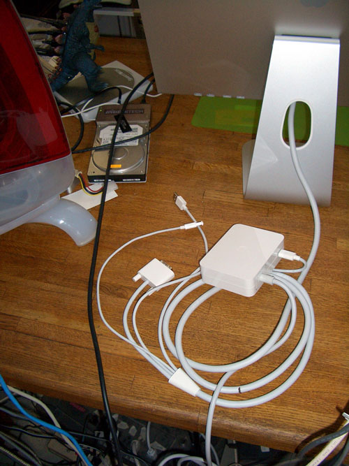

Because here is what you need with the display:
Here is the cables & power-brick for the Apple display:
Notice the big power brick; that has two ports...one for the OUTLET CABLE (3-prong power cable) and a smaller magnetic cable that is attached to the back of the cinema display)
There are four cables;
1) DVI cable
2) USB Cable
3) FireWire Cable
4) Small power lead to the Power-brick which supplies power to the display itself
then you have the Power Brick; which just has the 3-Pronged cable that pugs into it then the wall.
Thanks so much Thirteen, that clarified completely. I bought this off someone on Craigslist and had assumed they'd given me all I need, but my fault for overlooking the obvious.
