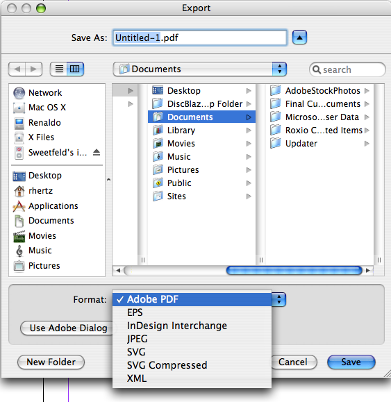

I am trying to familiarize myself with InDesign CS2, since i haven't used it since ver. 1.0. I guess i would like to know why when i do a Save As, i can save it as a CS2 doc; but i don't get any options to save as an older version.
How do i go about saving a file from CS2, down to CS? At home i have CS2, and at school, where i sometimes need to print large documents, they only have InDesign CS.
I have tried opening the doc in CS, didn't work, it said that i needed to get the latest plugin's or update to CS2. CS2 on gives me the option to save as a document, or a template. However, if i try to Export..., it gives me these options: [attached image]
So what do i do?
So what do i do?
I believe that you need to save it as an Indesign Interchange format and that will take care of everything. The only thing I can see as a problem is that sometimes the fonts get confused and you have to relink them. Other than that, you can open it in CS and 2 just fine.
yes i also tried that too. but indesign told me that it was unable to open it. So the only solution i found is to save it as a PDF, which i can't later on edit, in order to print it.
If they need those fonts, pre-flight and package it out from CS2. The folder from the package is where you want to save the exported .INX file to. That way you can send the whole package to the other user on CS1, fonts and all.
To open an .INX file. Make sure the CS1 app has the current update that allows .INX support from CS2.

I also had the same problem with CS2 at home and CS at school. I found a way to fix this problem. Adobe has an update for the CS app ( just make sure you are getting the MAC version). Here is the link to the URL to the description of the patch http://www.adobe.com/support/techdocs/331351.html
and here is the url to the actual MAC patch that you have to install
http://www.adobe.com/support/downloads/detail.jsp?ftpID=2448
Hope this works for you as it did for me. All you have to do is save ur CS2 ID under file > export > and InDesign Interchange format and you should be set 😀 😀 😀 😀 Good Luck!
Thanks, I finally got it to work! I still think it is stupid to have to do this though.
But, Thanks again guys for all your help.
