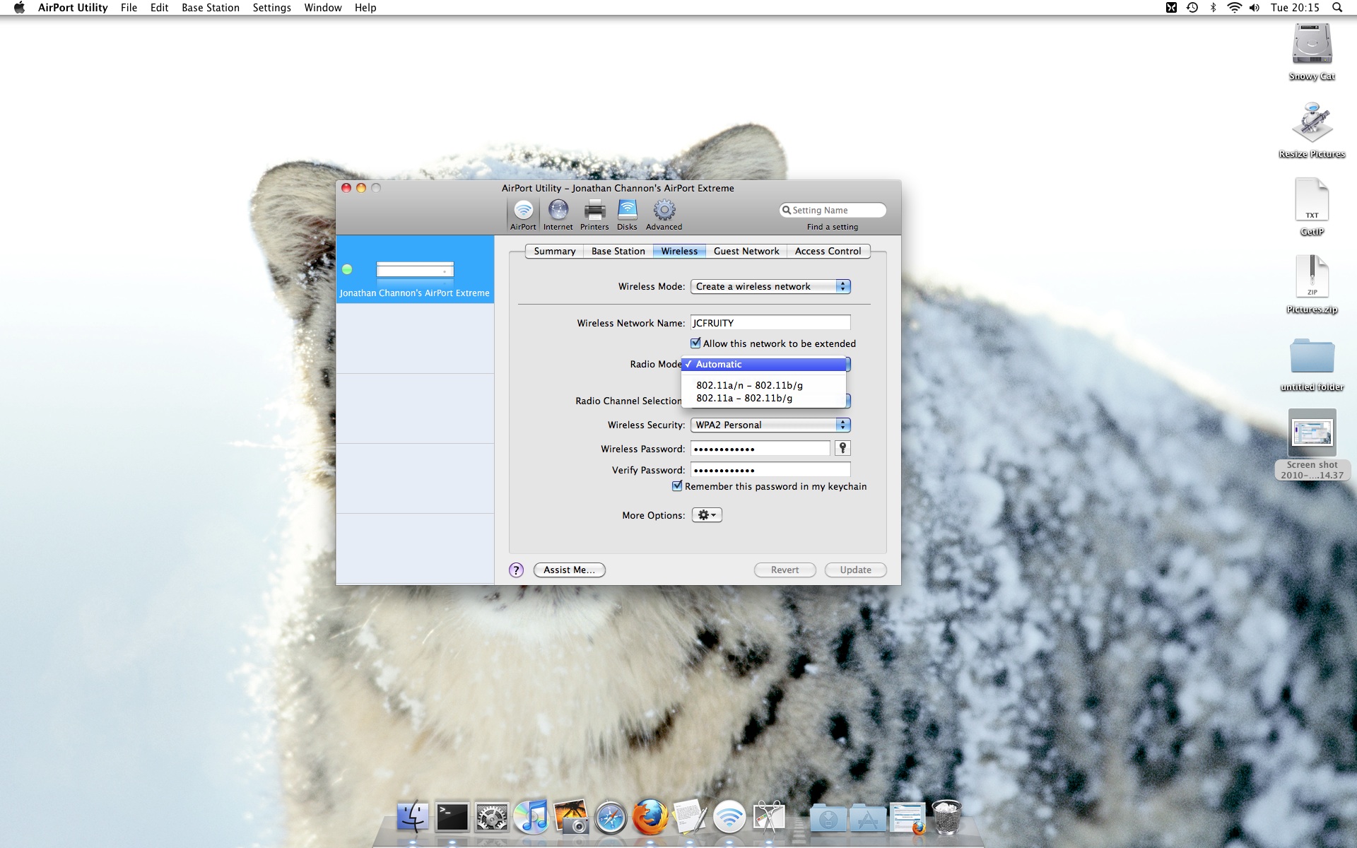

I have just bought a AEBS and all works on a 2.4Ghz network.
I think I have set it up correctly. I can see my wireless network with 5Ghz in brackets in my Airport menu but I can't connect to it, just times out. I have read this seems to be a firmware issue for the AEBS on 7.5
I can't see in Airport Utility to set the Radio mode to 'N' only, I only have 2 options as shown in the attached.
Any ideas?

Hold down command as you select that drop down list - then it all appears.

Have you tried resetting and reconfiguring your (dualband?) Extreme? You'll undoubtedly have to go back to Manual setup to make it N only, but whenever it doesn't "just work" a reset/reconfigure or a power cycle usually takes care of it.
Have tweaked the settings numerous times but no luck.
