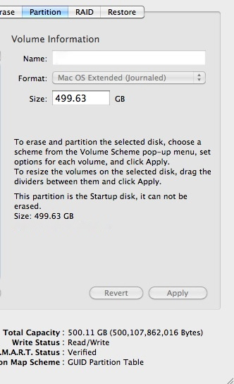

Thanks. When you say format your SSD, what does it mean. Will it be as easy as pressing a "Format" button, or will I have to know some specifics.

Also to format just pick a number/size of partition, select GUID when presented with the option and select Mac OS Extended.
