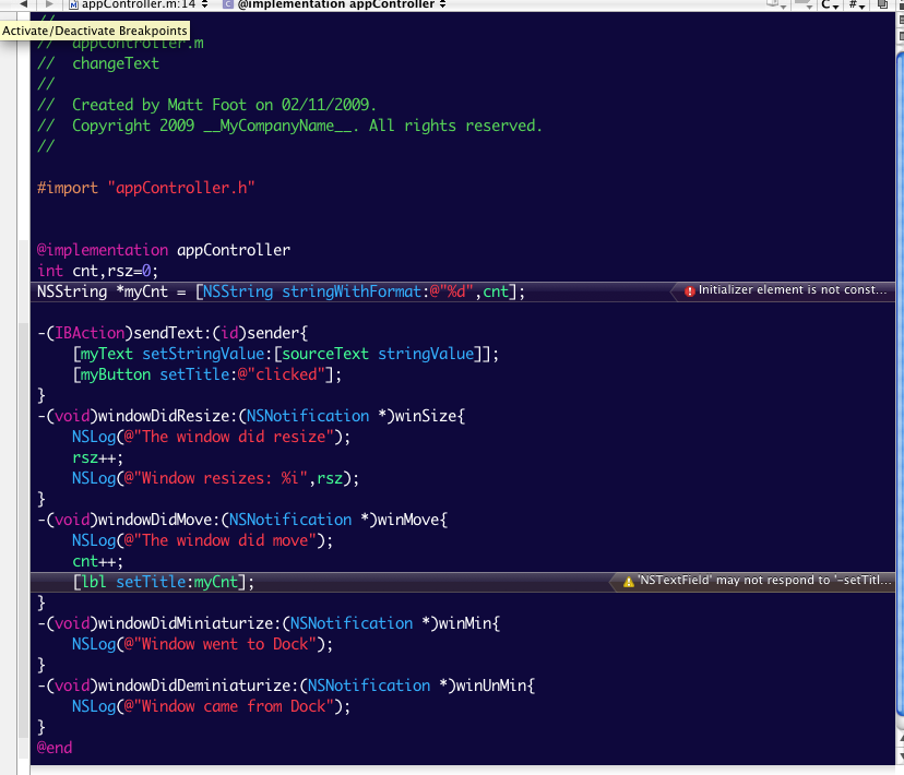

    Hi there. Objective C is extremely fiddly and convoluted, in my eyes. I want to take this code:
    Code:
    @implementation appController
    int cnt,rsz=0;
    -(IBAction)sendText:(id)sender{
    	[myText setStringValue:[sourceText stringValue]];
    	[myButton setTitle:@"clicked"];
    -(void)windowDidResize:(NSNotification *)winSize{
    	NSLog(@"The window did resize");
    	rsz++;
    	NSLog(@"Window resizes: %i",rsz);
    -(void)windowDidMove:(NSNotification *)winMove{
    	NSLog(@"The window did move");
    	cnt++;
    	NSLog(@"Window moved %i times",cnt);
    -(void)windowDidMiniaturize:(NSNotification *)winMin{
    	NSLog(@"Window went to Dock");
    -(void)windowDidDeminiaturize:(NSNotification *)winUnMin{
    	NSLog(@"Window came from Dock");
    @end
    ... and I want the number of times the window was moved, to be output to a label. I am told I need to do some kind of string conversion :confused: whatever that means, and had some smartass IRC guy keep linking me to Apple's documents, when in fact, all I wanted was a little help (this is why IRC earns it's rep as code snobs!!).
    Please - what do I convert to what, FROM what?. I just want the value stored in 'cnt' to be output to a label - can it be THAT hard to explain?.
    Thanks.
  2. lee1210 macrumors 68040
    lee1210
    Joined:
    Jan 10, 2005
    Location:
    Dallas, TX
    #2
    The docs are actually very good, and i'm going to link them here, but hopefully this will be a bit more helpful:
    http://developer.apple.com/mac/libr.../apple_ref/occ/clm/NSString/stringWithFormat:
    You should be able to get an NSString with the value of your number like this:
    Code:
    NSString *myCntString = [NSString stringWithFormat:@"%d",cnt];
    You can then use setStringValue: on the label to set it to myCntString.
    -Lee
    EDIT: There are tons of ways to do this, this is the first that occurred to me... you could do:
    Code:
    NSString *myCntString = [[NSNumber numberWithInt:cnt] stringValue];

    You need something like this:
    Code:
    NSString* convertedStr = [NSString stringWithFormat: @"%d", cnt];
    "%d" specifies a signed 32-bit int (see here if you want to convert anything other than an int).
    Hope that helps..

  5. kainjow Moderator emeritus
    kainjow
    Joined:
    Jun 15, 2000
    #5
    You can't put method calls outside of a class. They must go inside a class method, such as init.
    You should also declare those as instance variables, not just global.
    And for that warning about NSTextField, use setStringValue: - setTitle: is for buttons.
  6. glossywhite thread starter macrumors 65816
    glossywhite
    Joined:
    Feb 28, 2008
    #6
    ??? could you speak in English please :D
    I got the setTitle part - I worked that out, thanks.
  7. whooleytoo macrumors 604
    whooleytoo
    Joined:
    Aug 2, 2002
    Location:
    Cork, Ireland.
    #7
    Wot kainjow said u above.. :)
    You just need to to put that line in a method. So, in windowDidMove, you could update the textfield that shows the cnt variable.
    Edit; too late again!
