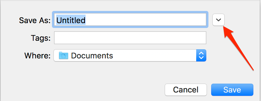

I don't have Word, so this may look a little different. When you click save, do you get something like this? Click where I have marked with the red arrow and it should expand to show a column on the left that looks sort of like Finder. Under Devices in the column you should see your USB key to select and save to.
You can see what I am talking about here.
