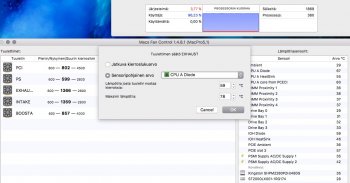

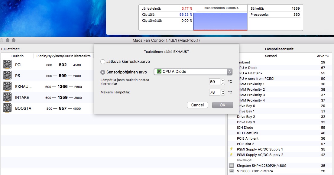

But my current fan settings can be read from attachment pic. All 6 cores do cinerender. I have adjusted the exhaust and intake fans similarly to each other, and now CPU diode keeps at 66. I will have to losen it a little bit, there's too much noise now.
It's been speculated before that Macs Fan Control gives a wrong number for CPU A (B) from PCECI. It seems so, it should be declining under heavy load, not increasing. But I am not sure.

I agree. the "CPU A/B core from PCECI" is inverted, meaning that 100 is actually 0.
If you look at iStats Menus you'll see a better idea of how far away you are to the ProcHot value, which is inversely correlated with the "CPU A/B core from PCECI" value:
https://i.imgur.com/aYgBMoj.png
