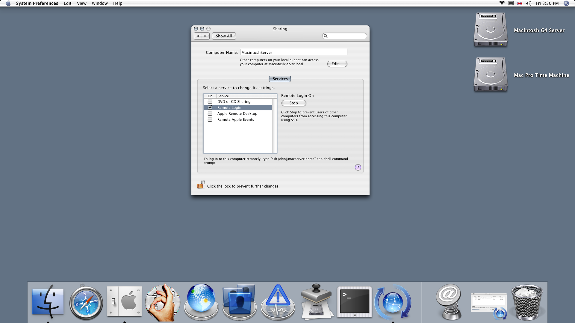

There is only remote login, Apple Remote Desktop, and remote apple events under sharing. What do I do?

I put an airport card inside with came today and updated the os to 10.4.11
This is how it looks.
Doesn't seem normal - what's wrong?
With OS X Server 10.4, you need the Server Admin tools to set up file sharing. However, if you're only doing file sharing to 3 users and not running other services, you may find it easier to just use regular OS X.
