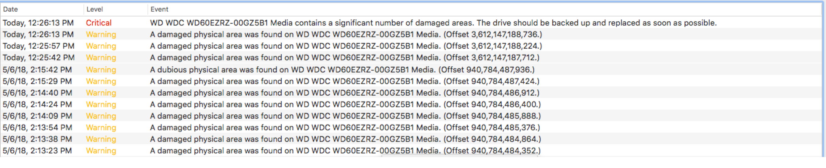

Drive Genius 5 has found significant media problems with a 3 month old 6GB Western Digital USB 3 drive (see screenshot).
I have the data (mostly) backed up, but I'm rather taken aback at this. What are the odds these are false positives? How can I verify this report? Since DG gives location information for the "damaged physical area" is there any way to verify those particular areas? (i.e., since scanning all of a 6TB drive would take a really long time I'd like to check the specifically reported areas)

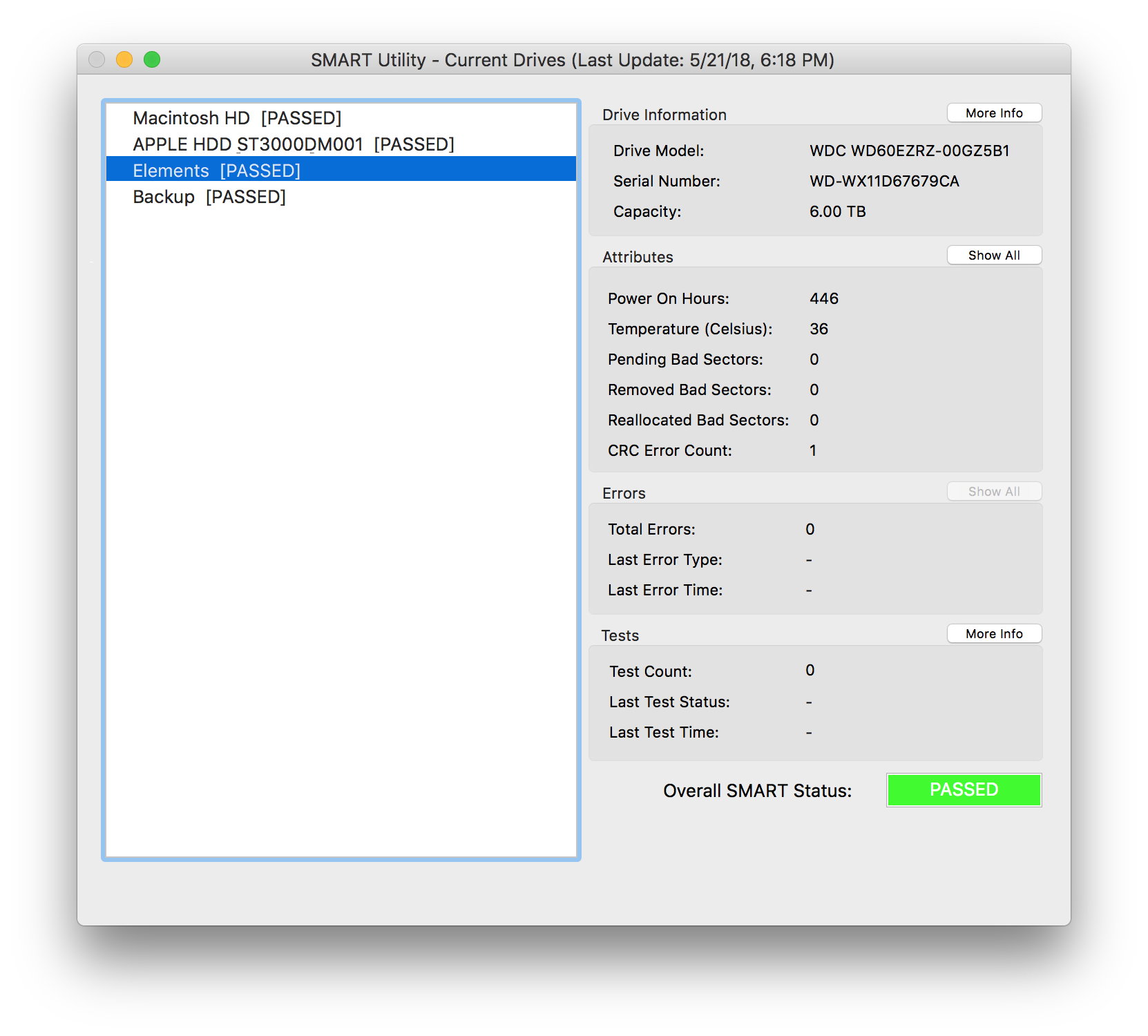

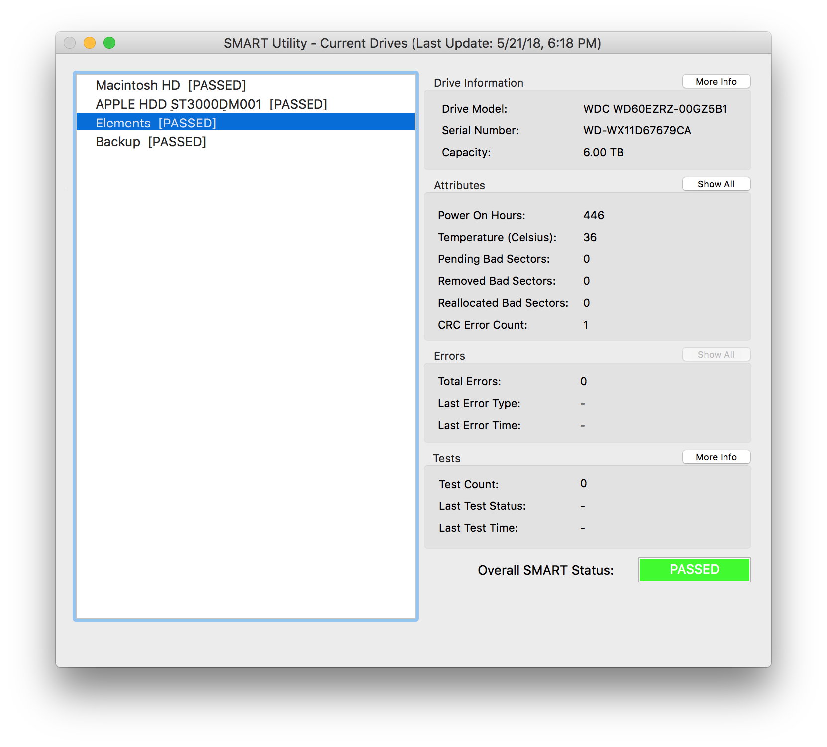

(definitely the internal drive you checked? SMART Utility will by default only pick the boot drive, unless the disk in question was the boot drive)
It was a USB drive that’s having the issues, and yes I checked it.
Oh OK, it's just SMART data doesn't natively work for USB drives in macOS IIRC, not sure if that's changed on newer versions. Best to check without the drive plugged in & then check with plugged in.
If the drive shows up as an additional one when it is plugged in and it still comes back clean, all good. If not, you'll need to download SATSMART, then restart your machine to enable macOS to be able to read SMART data from external drives & then check again.
It's possible I installed something along those lines once upon a time, because it's definitely testing and passing the drive in question.
