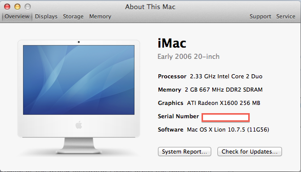

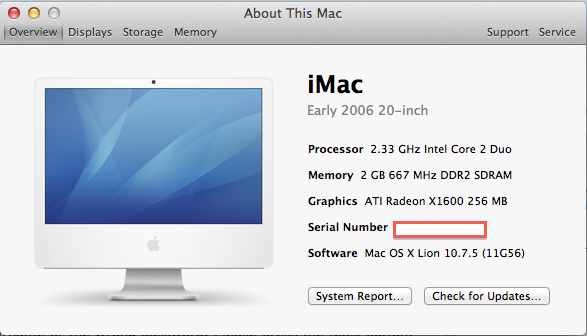

BTW I also found a guide here that seems to be working. Scroll down to the summary post on June 23rd. I did not use a USB disk; I just created an 8GB partition on my hard drive for the installer partition - modified as described - booted to it - and installer is now running. Fingers crossed 😛
Edit: Success!!
Now, don't suppose anyone has two 2GB DDR2 SODIMMs that they'd trade for two 2GB DDR3 SODIMMs??
Edit: Success!!
