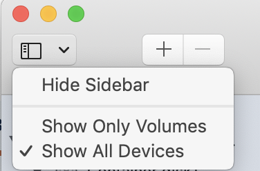

First... don't install any software from WD. You don't need it.
Attach the drive and launch Disk Utility. Then select this checkbox option I have shown.

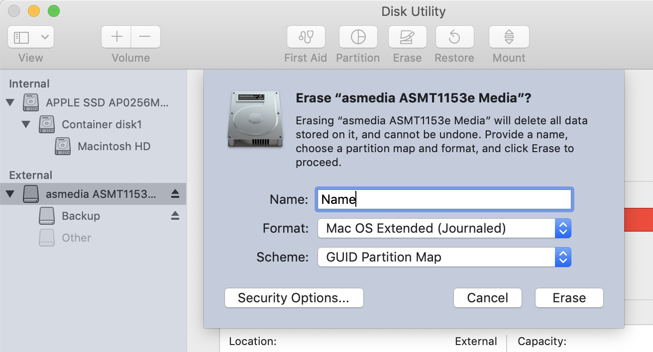

Now select the drive itself on the left side. Mine says asmedia... your will be WD something or other. Make sure you pick the drive just like in my screenshot and not any of the partitions below it.
Now click the erase button and set it up like my screenshot. Put whatever you want for name then click erase. This will give you a freshly formatted drive suitable for Time Machine backups.
