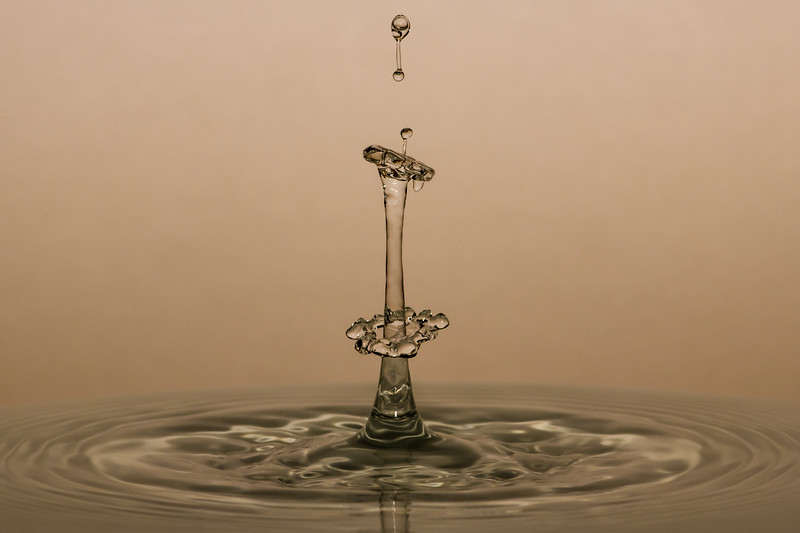

The shot above was done with thickened water, a white backdrop and amber speedlight gels.

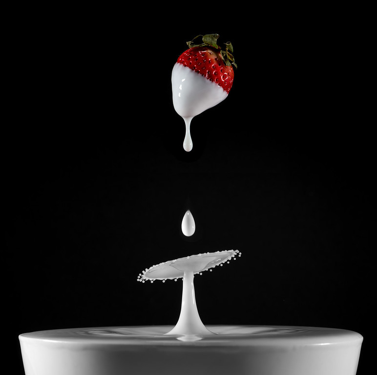

The shot below is a three shot Photoshop composite:
  1. light coffee cream drop in the bowl with drop collision
  2. light coffee cream drop in mid air - shape changed from round to teardrop using "puppet warp" in Ps, and
  3. the strawberry - it was tough to get the white of the berry and shape of the hanging drop right. I finally ended-up dunking the berry into some hand cream diluted with a bit of milk.
The three shots were adjusted using "levels" to get the whites to all match, "free transform" to balance the size of each layer and then composite layered - in Ps.
