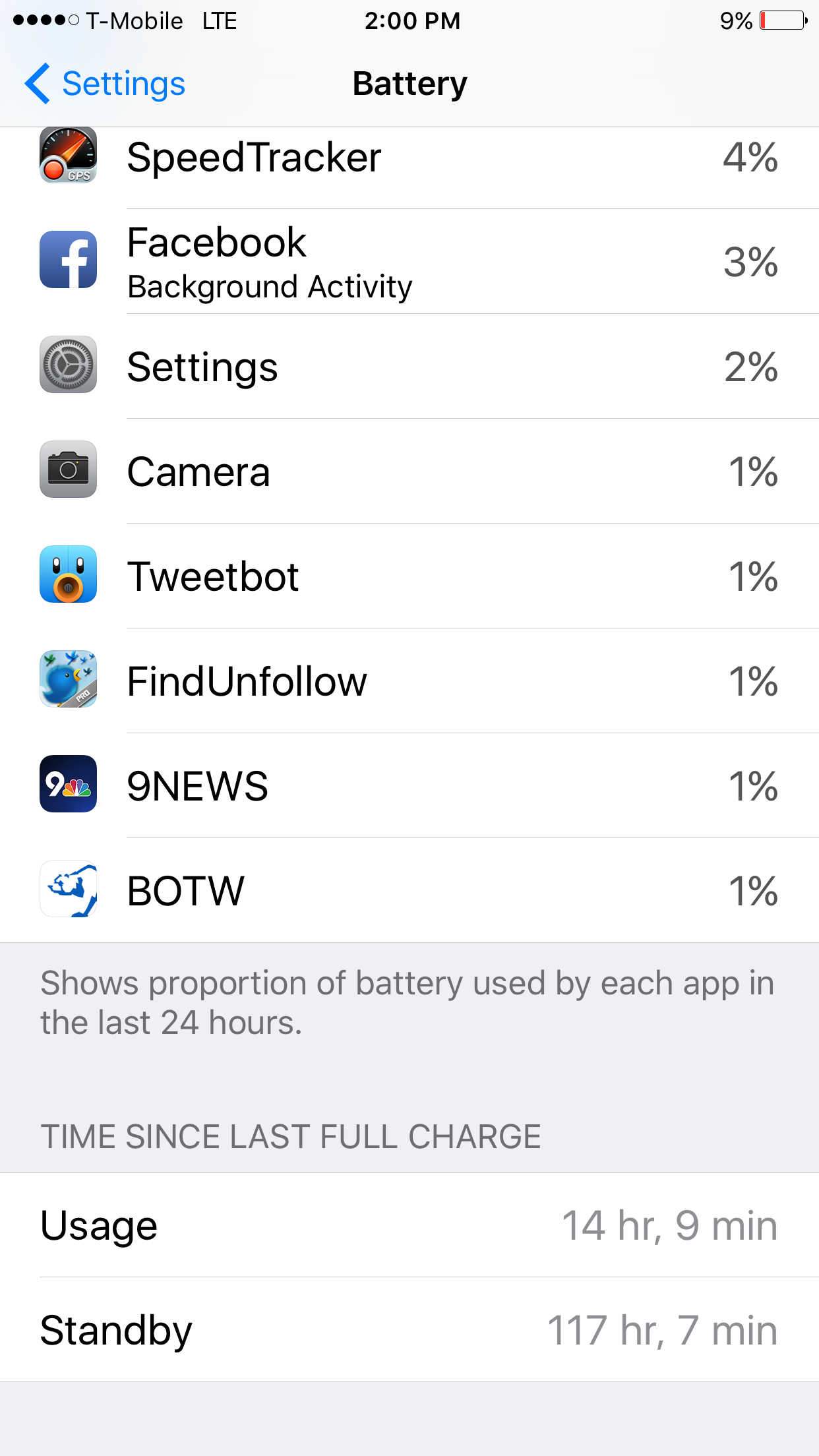

I'm doomed. It has 286 cycles in just 8 months according to Battery Life app (am I reading this right?). 6s Samsung chip.
Don't you use it at all?!
Every day. With my average usage, yes, the battery goes for several days. I don't play any games, just apps such as Facebook, Instagram and a few other apps. You can see in the screen cap below, it does not say that the phone has been plugged in since last charge. This is on one charge.
