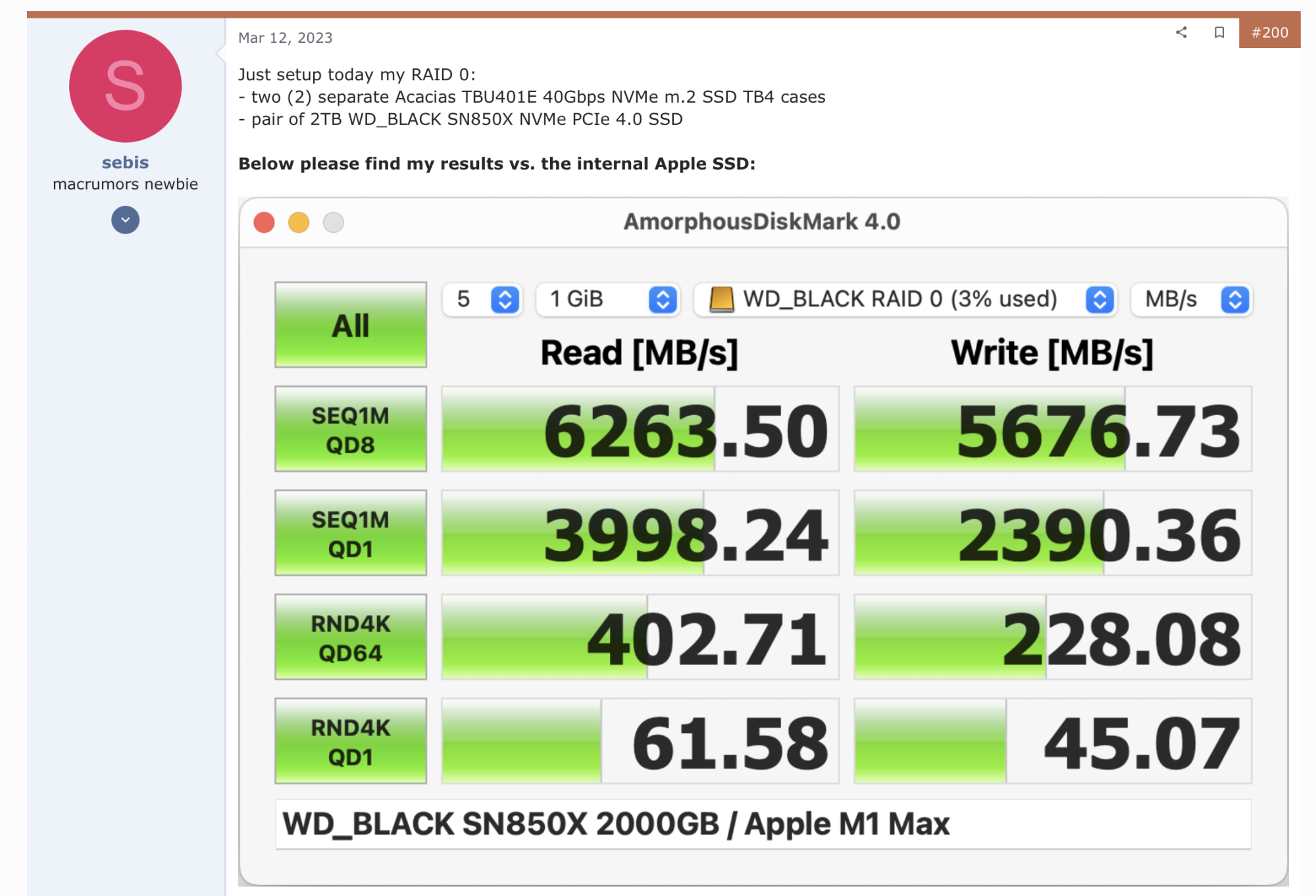

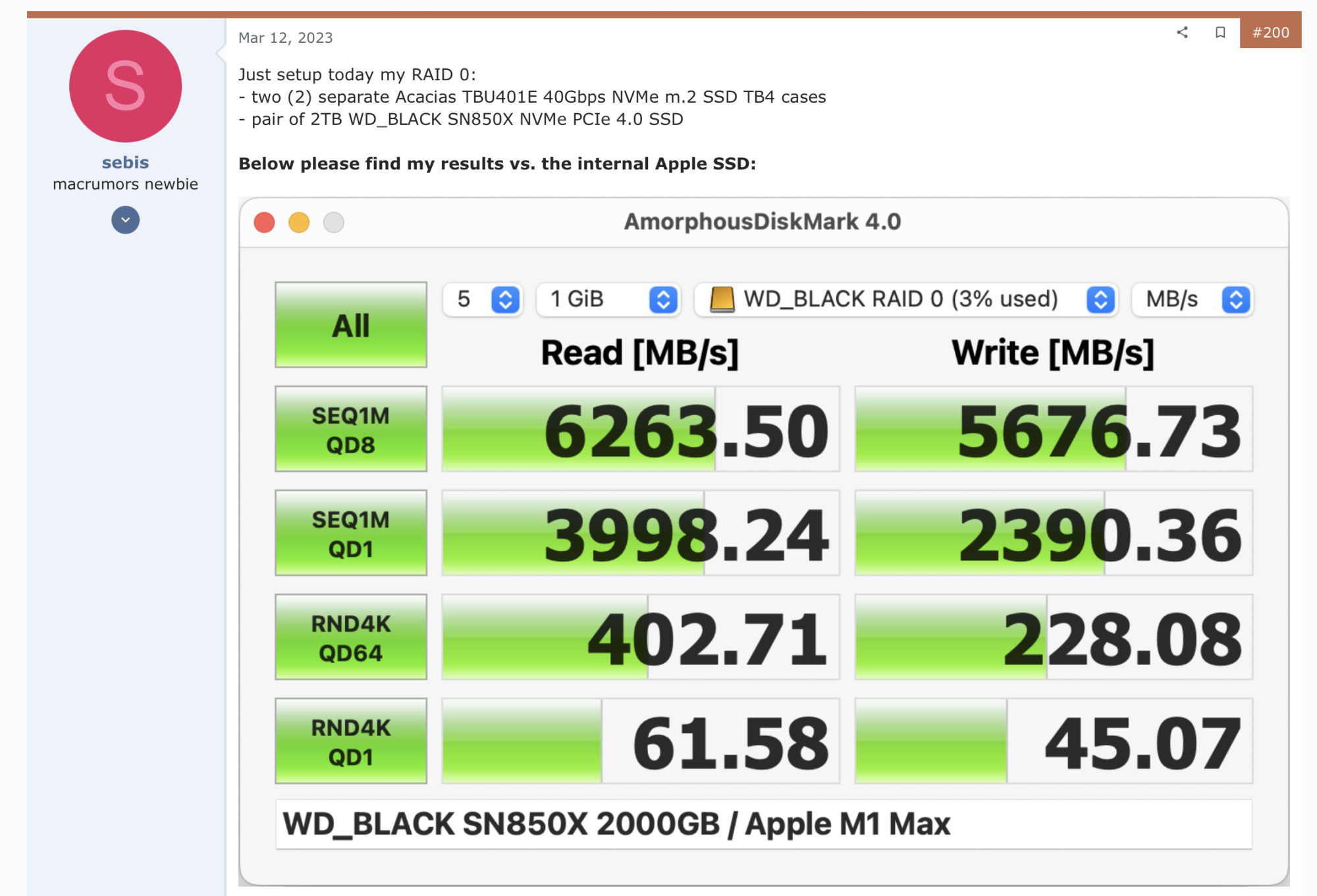

It is actually possible, some people on MacRumors did it. I'll get two enclosures and do a RAID 0 on both drives, this way I can get 40 Gb/s.
I take it you're referring to something like this:
Reactions: Silly John Fatty
For example, yes. I've seen multiple people do it, and it technically makes sense. 40 Gb/s with one Thunderbolt controller isn't possible for data, because around half of that is reserved for video/displays, etc.
But if you use two controllers, where you get around 20 Gb/s each and then put your drive in a RAID 0 format, you get around 40 Gb/s.
You'll need a Mac that has two Thunderbolt controllers, however. On the Mac minis it's one controller per two Thunderbolt ports. So the models with two TB ports have one TB controller, the models with four ports have two controllers.

I'm not sure about the MacBooks. I have the Mini M2 Pro and it has, from what I've heard, 2 TB controllers, and a total of four TB ports.
The 40 Gb/s refer (from what I've understood) to a single Thunderbolt controller, not to your Mac in total. So in total you'd theoretically have 80 Gb/s, if you had 2 controllers (it must be that way, otherwise some people wouldn't be able to get 40 Gb/s with data transfer).
So you have a total of 80 Gb/s, of which you can use a little more than half for your data transfer, while you can use the rest for your displays.
