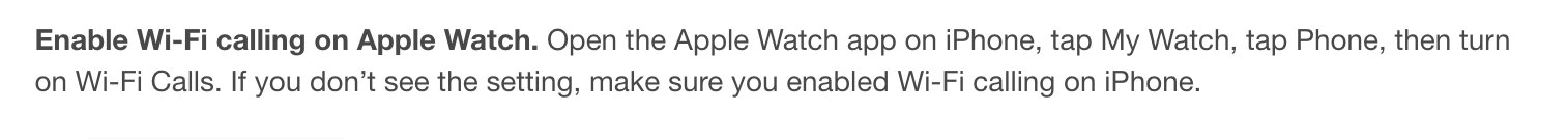

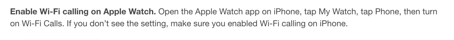

how do you know if wifi calling is turned on for apple watch? Does that mean wifi calling has to be turned on for the phone as well?
[doublepost=1506630782][/doublepost]
Yes
If you don't see the setting on the watch, make sure you enabled Wi-Fi calling on iPhone
