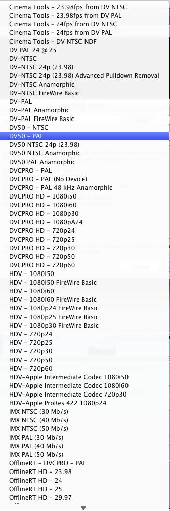

I don't know that camera. I've got a much less expensive Panasonic AG-HMC40. However, I looked at my FCS list of import formats and it include a range of DVCPRO types. Looks like the camera will work with FCS. Good luck.

Thanks! The only item google search turned up was basically an ad by a company wanting to sell a piece of conversion software...so glad to hear is should work via log and transfer
