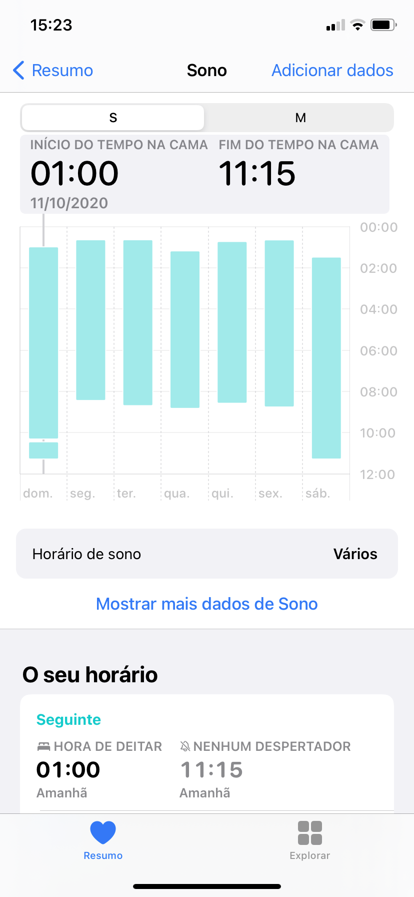

I woke up an hour early last Sunday ("dom." on the screenshot) but didn't turn off sleep mode to see if it would figure out I was awake. My sleep data for that day shows a break when I first used the phone but then it shows I was asleep until my waking hour. So the first time I interacted with it, it realizes I woke up but not the following times.
Today ("sáb.") I also woke up an hour early but this time I turned off sleep mode. I still got the "waking up" screen at the scheduled time and on the sleep data it doesn't show any break at all, even though I was using the phone. I don't have an Apple Watch, I don't know if that makes a difference.
