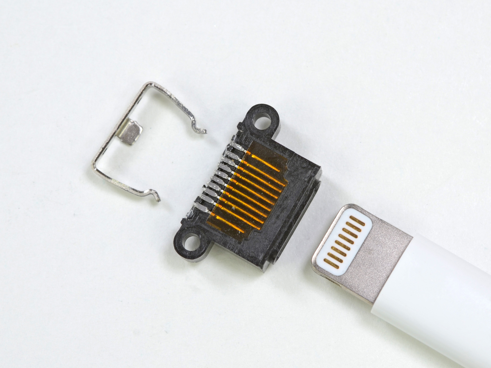

I am trying to figure out how the lightening cable snaps into place into the lightening port? This is more of a curiosity thing. I have looked online and can't find anything. The port must secure it somehow. Does anyone know how or have a link to an article?

The sides of the metal tip on the plug have divots. The sides of the port have little springs that lock into the divots.
Well must be the lack of springs on my phone’s port since the same plugs that fit snugly in the iPad doesn’t hold on my phone.
If you look at the sides of the male end, you will see two little dimples. A metal spring clip holds it in.

Thanks for the info and the pics that show in detail how the darn thing works. Gotta look inside mine and see what’s wrong. I never tried any sort of metal object to clean out the lint..but did try a toothpick but not on the sides. I always figured metal was a no-no as it might short something out.
