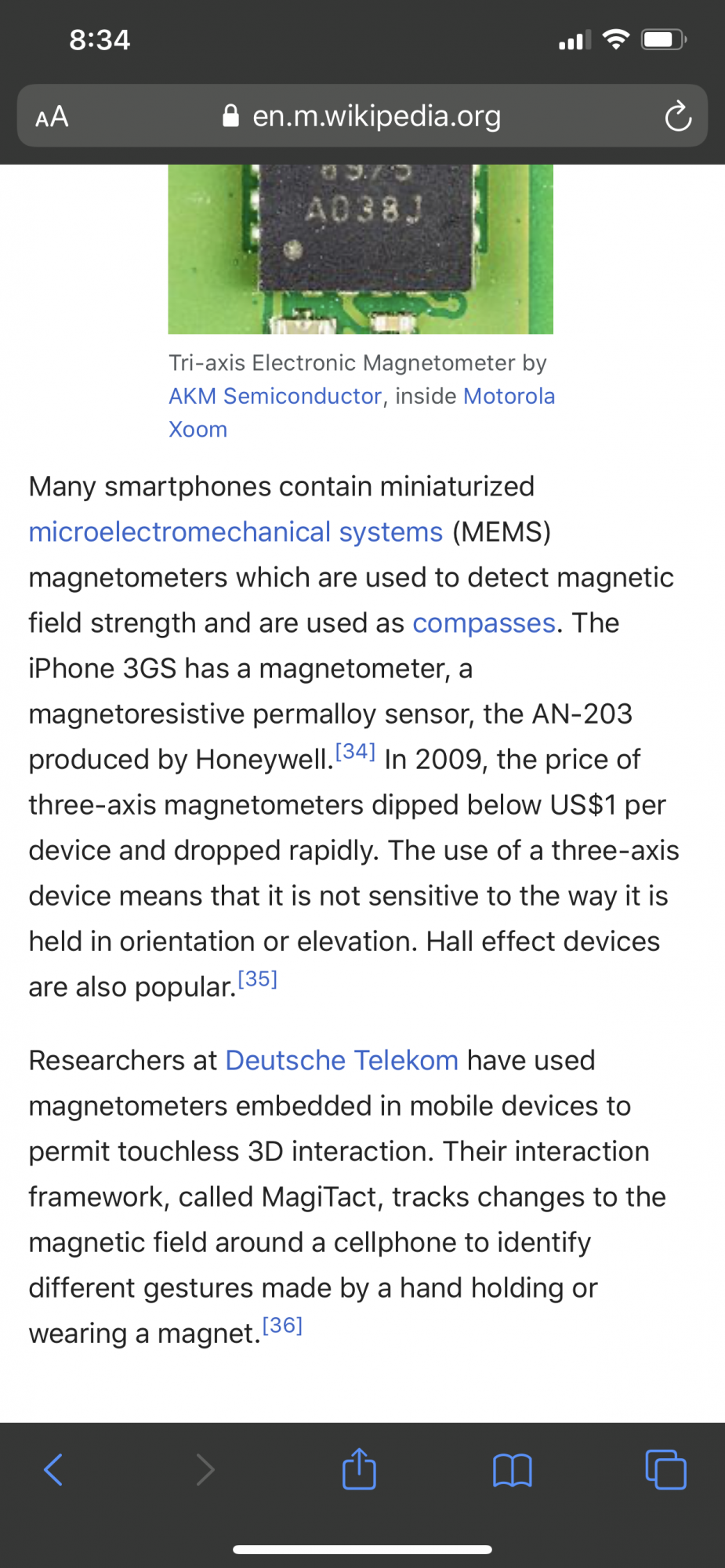

I do not know how they get it to work, but it does work absolutely correct.
I can take my real compass and compare it, and it is spot on, so that math or whatever it is doing to compensate for possible interference is working.
Edit: Also, yes, the article above me from Wikipedia does essentially answer your question, in my opinion.
:apple:
It doesn't explain how it avoids interference from the adjacent magnet. Apple has admitted that bands with magnets in them will affect it, and experiments I've conducted with similar strength magnets at similar distances clearly do. Are you saying that they just are in fact sensitive enough to register the earth's magnetic field on top of the magnet's? If that's the case, then I don't understand what a gyroscope would have to do with this issue of the embedded magnet.
