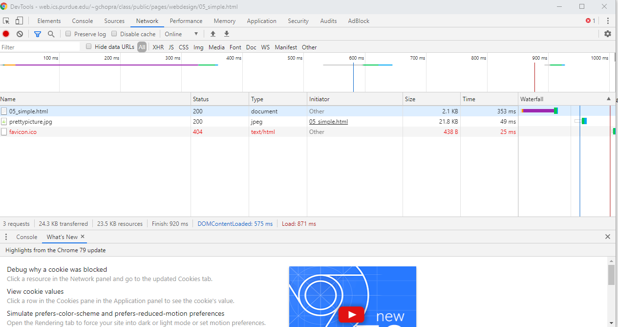

Here is an example:
Simple web page

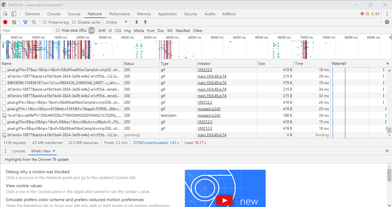

Here is macrumors:
The simple page has no javascript. No ads. Just pure HTML. Macrumors has a ton of scripts being loaded along with stylesheets and images. But even still we are only talking about MBs of data. The bottleneck here is probably going to be your computer and your browser before the connection speed.
