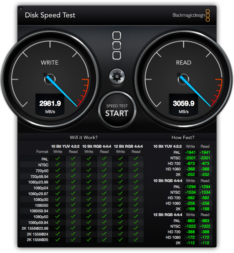

Try tests with a RAM disk...
I usually answer this information by grabbing a free utility and creating a temporary RAM disk on my computer. Of course, you can't do full scale tests, because what you're doing must fit in your ram disk and in the remaining RAM of your computer. But it reveals a lot. It acts as a "limit case" - how fast would your workflow go if you had a fast hard drive.
The thing about hard drives is they don't matter all the time, but when they do, it's typically an "all stop" while waiting for them.
I just ran Black Magic Design's Disk Speed Test on a 6GB RAM Disk
For perspective, I just created a 6 GB RAM Drive using RamDiskCreator, then ran Black Magic Design's iconic Disk Speed Test on it. Both read and write sustained rates above 1.2 GB/second. (The DRAM is of course much faster than that, but I guess emulating a mounted hard drive adds a lot of overhead.)
The RAM disk results are as fast as any SSD RAID result I've ever seen, so it's a pretty good way to say, "what if I had an awesome hard drive?"
For info, you can achieve a much faster speed with RAM driver.
