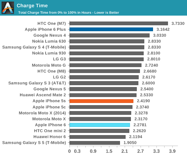

"Fortunately, based on the USB device information for the phones, both the iPhone 6 and 6 Plus support charging with power adapters like the iPad charging block that can provide up to 2.1 amps at five volts. Using one of these chargers will dramatically reduce charge time on the new iPhones, and it's a very worthwhile investment (assuming you don't already have an iPad) for the iPhone 6 Plus in particular." anandtech iPhone 6 Review

That seems a little strange considering. With the regular charger it should take about 2 hours according to anandtech.

On the iPhone 6, using the iPad chargers doesn't charge the battery faster - the maximum current going into the battery is the same between all chargers. What the 10 or 12w charger does is allow additional headroom to power the device such that the battery can take a full 5w, but if the device needs extra power, it can get it from the iPad chargers. This will have the effect of reducing the total charging time because you are not sharing the 5w between charging the battery and powering the device, as was the case with older iPhone versions.
The 6+ is different in that it can actually take more power in the battery.
