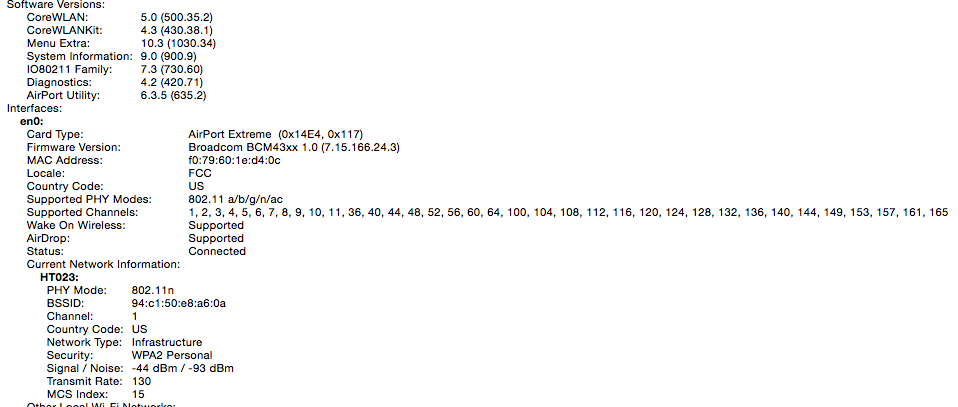

I changed from a 2010 iMac to a new Macbook Air 13.3. "About this Mac" says it is early 2015 so unless the Apple store completely cheated me, I guess this is the latest model.
My inquiry is what is the maximum Wi-fi speed available. I kept the iMac on Ethernet so I was unaware that this might be an issue. I have Ethernet on the Air through the Thunderbolt port and a dongle and make the expected 300Mb/s that I am paying for but if I unplug, the best I can do on Wi-fi is about 50Mb/s. Is this the maximum for my Wi-Fi or could it be a router issue? My router is ISP provided and works off of a fiber optic box. It will prioritize TV but I am testing with the TV off.
If 50Mb/s is the best the Airport card will do, I guess it is not too big an issue as I only intend light web browsing away from home and no heavy downloads when away.
Below is from System Report.
Thanks.
Reactions: cincygolfgrrl

I bought WiFi Explorer.app from the App Store. It showed my router having a maximum rate of 130 Mbps which is the same number that is reflected as Transmit Rate by System Information in the screenshot in my first post. It is looking to me like the limiting factor is the WiFi card in the laptop unless anyone can explain it differently. The app downloads info as .csv but this site would not let me upload that format so I hid the weaker neighbors and made it a pdf. My router is HT023 on the first data line.

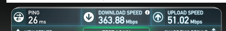

The 802.11ac wifi is quite fast on the newer MBA's. I have a 2013 and this is what I get connecting to a network drive on a Mac Mini over my LAN using a 2TB Airport TIme Capsule as a router. And this is MegaBYTES per second. :)
