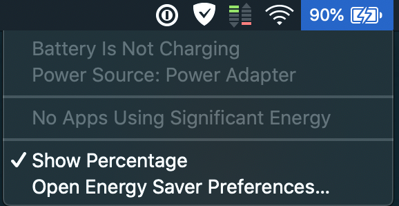

Just got a new 2020 MBP i5 4TB ports, and have it hooked up to a Dell USB-C monitor with 90watts of PD, which worked perfectly fine until suddenly the last two days, the laptop will go from fully charged to a slow drain, and the status says "Not Charging." I tried rebooting, turning off and on the monitor, unplugging other USB devices from the monitor, but it persists in the slow drain / "Not Charging" mode. Finally, I reset the T2 chip / SMC, and it immediately starts working again.
It happened again suddenly today (while idling)... so now I'm concerned and wondering if I should return/exchange.
Any thoughts on whether I have a dud MBP? I've used this Dell USB-C monitor with my old MBP, and it worked just fine, never had an issue. Thanks!

This happened to me as well and so far my research points towards this being a part of the new Battery Health feature. It's basically reducing the max. capacity of the battery and also letting it discharge to ~90% (according to indicator, in reality it's less than that) and back up to 100%. Some people reported the OS to be doing this once per day.
If this is the cause, turning off battery health should stop this from happening.
If it is a software feature related to battery management, resetting SMC would probably delete what the system has 'learned' about your usage and thus delay it from happening until it "learns" again.

Is this not part of the new battery health management feature?
Have you tried turning it off to see if that makes a difference?
