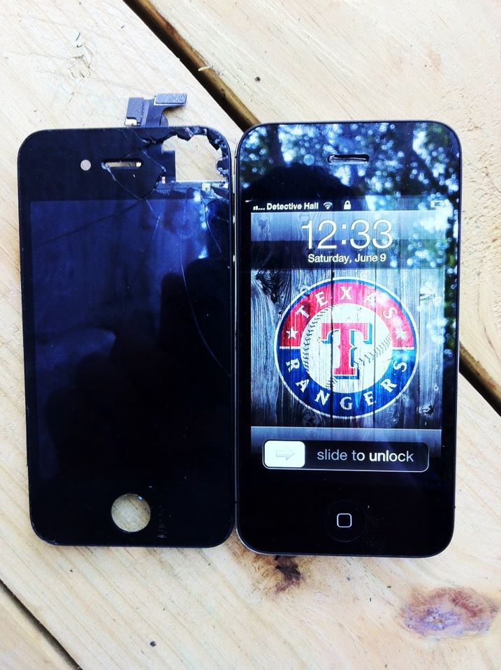

I've done it. The biggest problem I had was I stripped the head of one of those impossible to see tiny screws. It almost got the better of me but I finally won. If it hadn't been for that, it wouldn't have been too bad. Even with that issue I'd say it took me no more than an hour.
Go slow and use a screw guide. I found one that I printed out that helped a great deal. Just don't knock it off the table or bump it or anything.
You can see how bad mine was damaged -
Edited to add - Don't forget to switch the speaker screen!!

You use the same one. You actually have to switch over your home button and the speaker screen.
You can't really tell, but I forgot about the speaker..I wasn't going to take the whole thing apart again, so I kinda trimmed it to fit and shoved it down in there from the outside..
