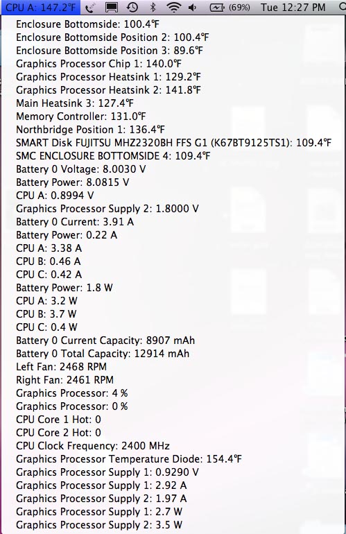

I have noticed my unibody gets considerably hotter with the 9600. The whole left palmrest and speaker grill is warm, almost hot to the touch.
I'm worried because I just bought a 22" monitor (not here yet) and I plan on using the 17" in clam shell. I don't want to melt the glossy screen or cook the laptop.
How hot is too hot? When should I be worried about damage? Today is a hot day. Its 75 degrees F. outside. I have a second monitor running and a handful of programs, PS, Firefox, Word, Acrobat, Entourage, Itunes.

So I'm about 34 degrees cooler on the 9400. Does that sound right?
that doesnt sound right. is that the temp when they are both idle? or while you are doing something graphic intensive. mine only shows about a 10 degree difference. im talking celsius btw. if you are talking Fahrenheit that would be about a 20 degree difference.
Second monitor running and PS, Firefox, Word, Acrobat, Entourage, Itunes....just open, not doing anything:
9600=145F
9400=111F
I haven't tested Idle with nothing open but I will.
9600=145F
9400=111F

How do you check the temperature of the laptop? I have Statpro, but there are like 10 different temps. Which one are you guys talking about?
the cpu temp is the main one that you should be watching. after that northbridge gpu and mem controller.
