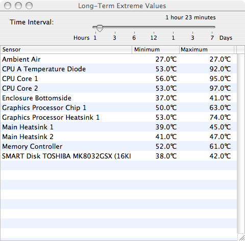

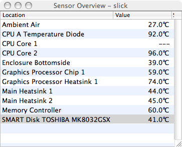

Reading a recent post make decide to log, again, working temperatures in my MBP Rev.A 15". I used Temperature Monitor ver. 4.2. Results are shown in the images attached. Numbers speak by themselves.
The "test" isn't more than running Safari, Firefox and Parallels with XPSP2 executing an ATI OpenGL demo. The demo is run for a couple of times with some idling in between.
In the first image, you can see the 2nd core temperature of is 96 C, but the first core is way to hot that the sensor has "passed out". ( Over 100 C ). Fans kick in soon, so the maximums are reached for no more than 30s. each time.
The second image shows the highs and lows of the last last 1h30m. It doesn't log with accuracy but it gets close.
Supposing the readings are accurate, I think this MBP is way too hot: I can't even touch the bottom of it with my hand. How can I ask Apple for this to be fixed?
As a curious thing to me, the main heatsinks values comparatively don't change much. See for instance the GPU heatsink.
Your opinions are very welcome. Thanks

At this very moment, the "official" outside temperature is 23C, and the Ambient Air sensor inside the machine steadily reports 27C, as shown in the attachments, though I've had readings ranging from 23C to 28C.
Well, I believe ambient temperature matters, though, only to the touch it seems to me, as the entire case is dissipating heat. After half an hour of running the fans at 6000rpm, mostly idling, the readings are now 46C for the cores and 35C for the heatsinks. Bottom is cool enough at 33C. HDD temp. is too low to have a reading.

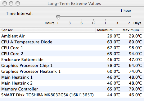

Right now I'm setting the minimum rpm with 29C of room temperature (28C outside), and CPU 90%+ idling, and battery recharging, as I type this the temperature is climbing up from 54C to 66C (core averages). Still at 1000rpm though. Bottomside is scalding at 45C.
One question: Can 75C at the memory controller sensor hurt the RAM?
-MBPmad
One more test
For your amusement, owe or sorrow, whichever may suit you, here is one more test.
Less than 5 minutes of a GPU intensive program and two browsers open.
The machine is well ventilated on top of a glass covered table, at a comfortable enough 29C ambient temperature. Battery recharging.
Again, numbers speak for themselves.
Question: How can I convince the guys at apple that I need them to fix it.
