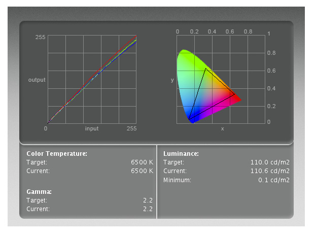

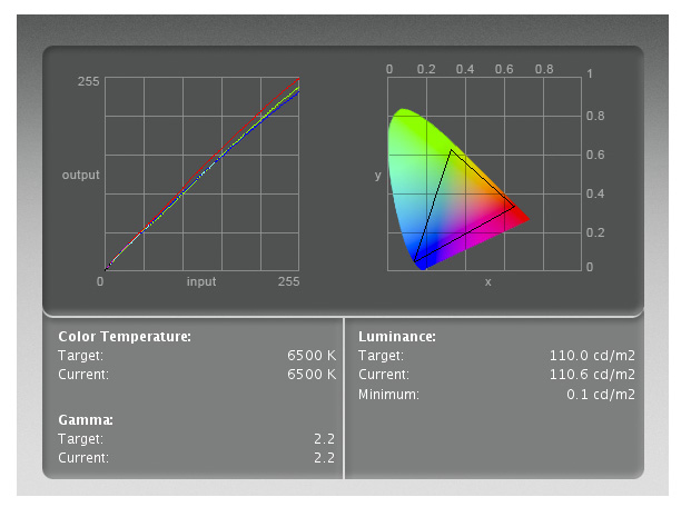

Overall the iMac is very good, I owned a 27" late 2009 iMac. I also sold it to get a high end monitor and now use a 26" wide gamut 12-bit non-glossy monitor with a MBP and there is no going back.
One final point, serious work requires serious calibration of the monitor. A iMac is limited in that during calibration you can only adjust brightness but overall one can get very good results with a calibrated iMac.
Below is a screen shot of my old iMac after calibration showing excellent sRGb coverage
