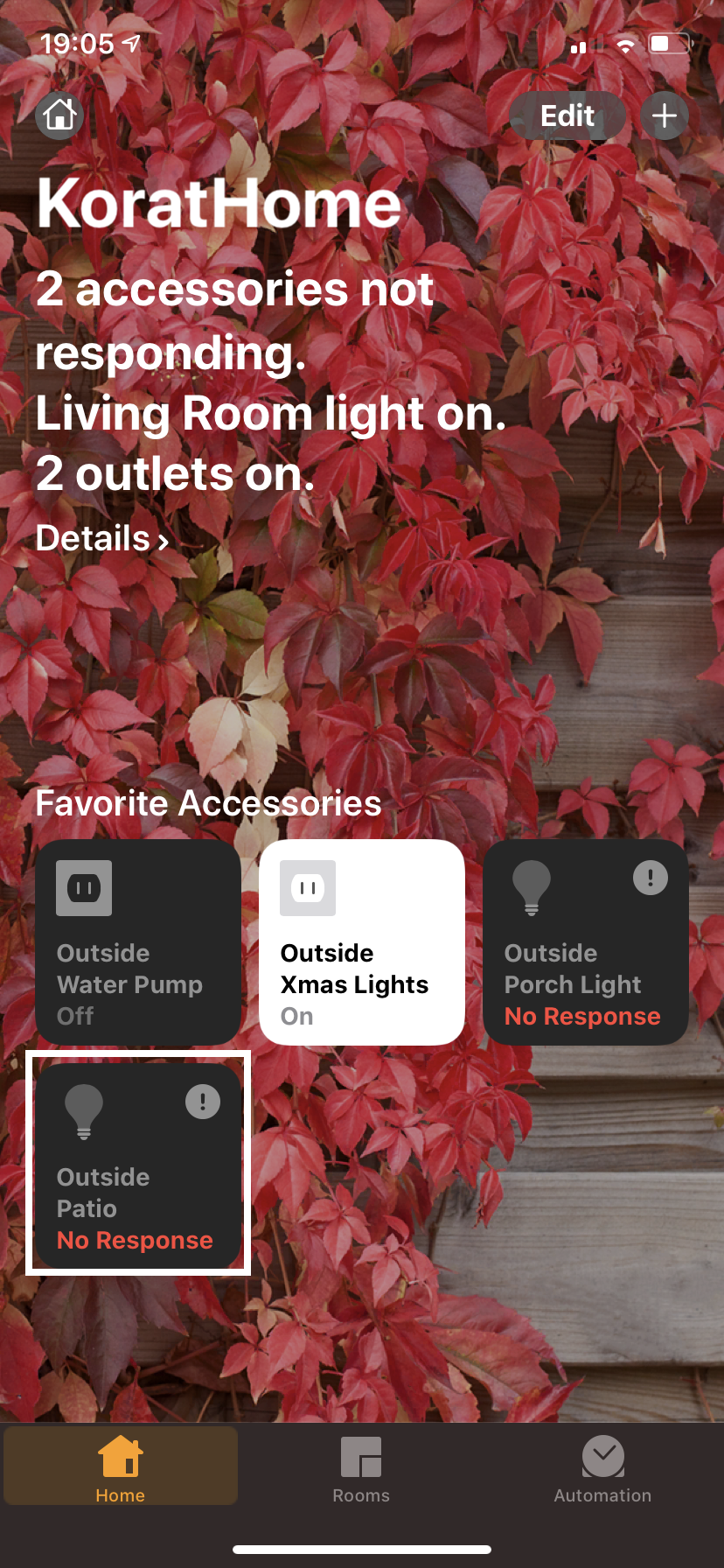

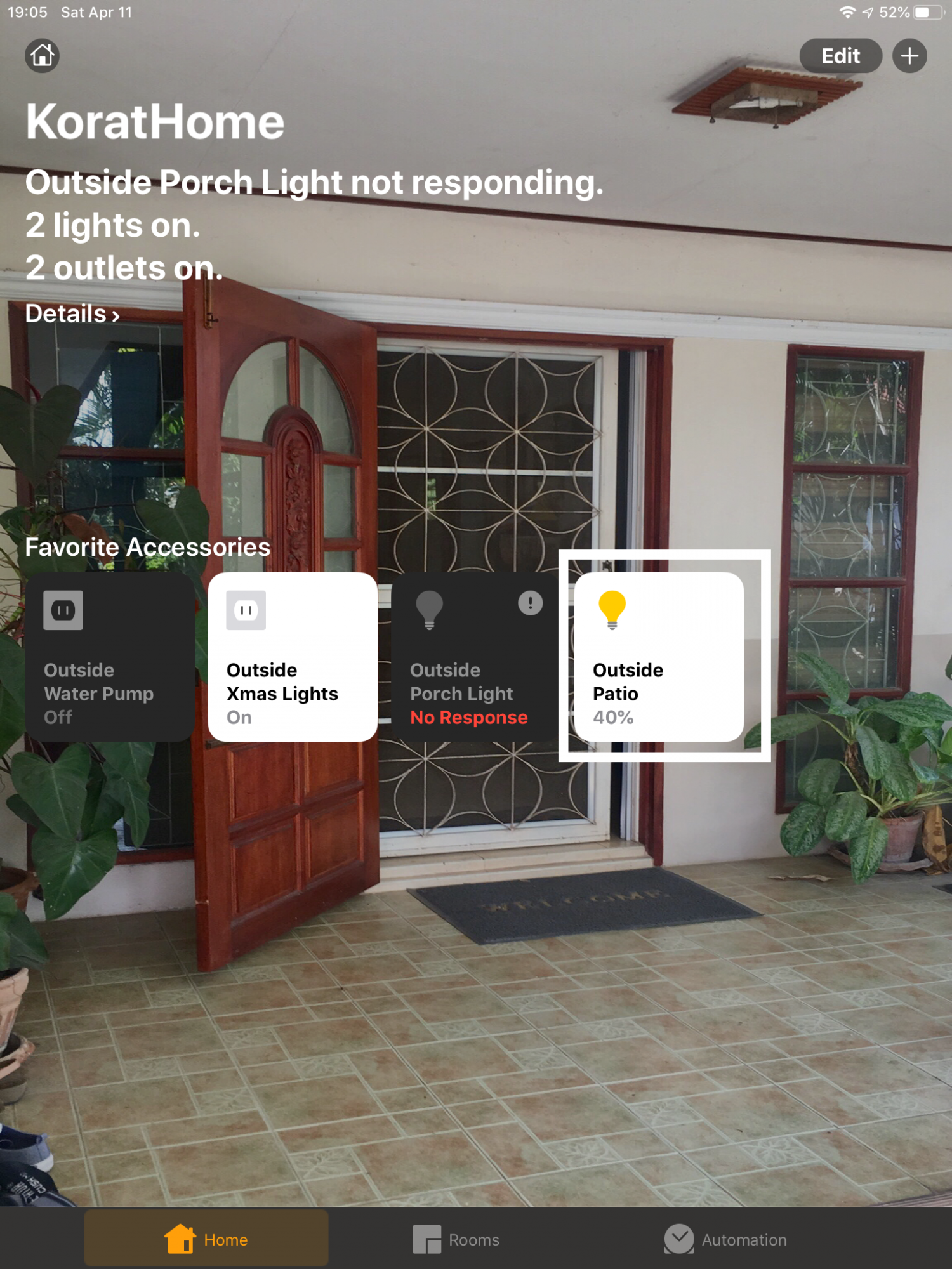

As you can see from the screenshots, my iPhone XR says there is "No Response" from the "Patio" light while my iPad mini 4 is connected to the "Patio" light and can still control it.
Automations with the Patio light no longer work.
How did this happen and how can I fix it?
